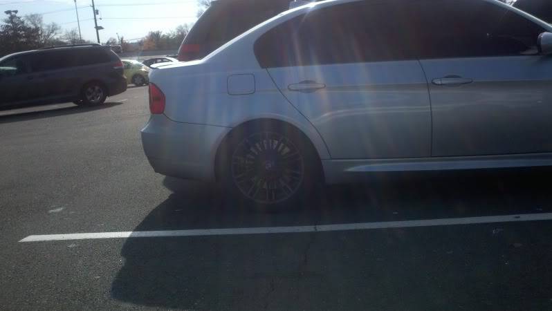

Pulled into mall lot today while shopping and parked next to a BMW that made me jealous :(
I would love to have a setup like this on my Mark :D
