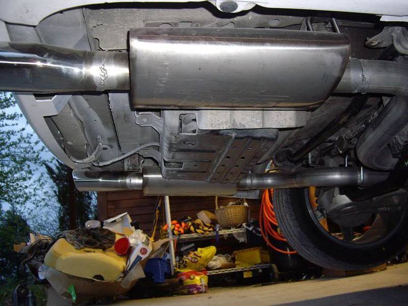

For quite a bit cheaper you could order the LMS exhaust and the Mandrel systems 2.5" pipe kit. It would have nicer tips then turn downs and sound motre agressive with the double x pipe. Should be around $400 plus install which ran me $250.
i have heard that the kit from mandrel pipes, requires some work to get it to fit. As far as the mufflers i wouldent get the turbos with the turndowns
I have the pipe kit and it fit with no mods at all. Fits pretty nice too.
sounds good. Where did u get that kit from i remember seeing it on here before just forgot where it was from.
Muuflers from some place out in East Texas, Magnaflow x-pipe from SCP and the pipes from Mandrel Bent Exhaust Systems. In it about $700 after labor and tips.

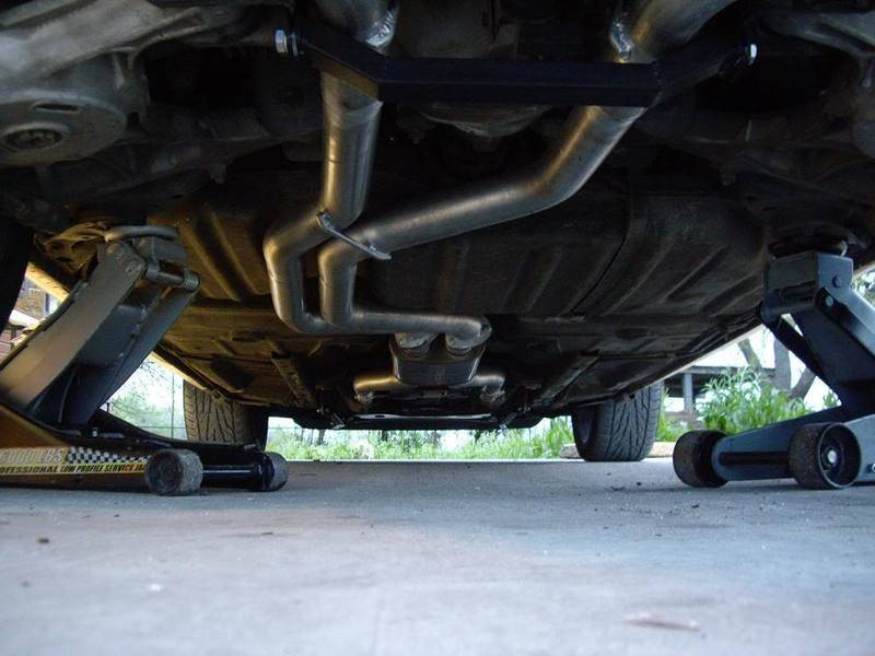

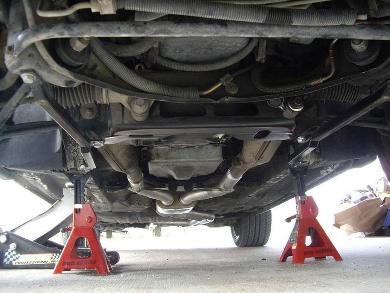

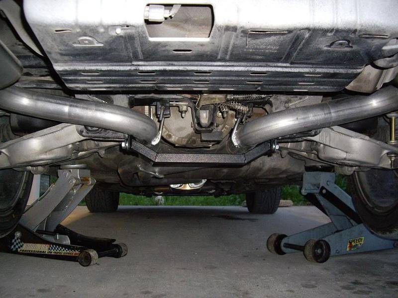

very nice, hey laser you have a better pic of that rear brace? i wanna see how yours is mounted.
well a bit to loud for me but sounds good. i know for fact that we all have different opinions and so we try to follow or do our own thing so. i did my exhaust thinking that it was gonna be all that, well what a big disapointment after i had it done now for about a month. so today i call (geno) and so i went to see that bad a.. mark viii and so i was so impress with the sound. wow it sounded beautiful it was the perfect sound not over drone like most mark vids that i have seen so i strongly recommend genos exhaust if i had the money to do it again i would go genos way for all of you who haven had the opportunity to meat or deal with him his a great guy geno, i will be back thanks .
Mine? Loud? :lol: Cant tell by cameras I guess. My car is FAR from loud. Its quieter then it was with knock off flowmasters and stock H-pipe. Not untill you are really on it can you hear it and its still too quiet. As for drone, It is nonexistant. Ask Sapperfire, hes cruised in the car from 30 -130mph and there is not a hint of drone. Its important to weld a piece of bar stock across both pipes so they dont drone.

I remember Geno offering some advice for LMS exhaust drone. Here is what he said:
If your still getting drone its from the harmonics of the piping because is such a long stretch.
We always tell people when they get it installed to weld flat stock across the two pipes every 6 inches or so to "solidify" the piping so the pipes will not hum/drone. If I failed to tell you this I apologize.
Ask anyone else about or system and drone. Its actually the most drone free set up I have heard yet.
Although before doing that, I'd check that the exhaust is hung correctly with rubber isolators and that the exhaust doesn't contact any part of the car's body.
