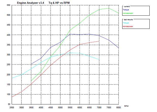

After much research I think I may be underestimating the build. Using Performance Trends Engine Analyzer software, I was able to closely replicate the current 4.6L setup and then compare it to the new 5.3L motor currently being built.
Using the same heads/cams/intake, we're looking at 50HP gain at 4500 rpms, 100HP gain by 5500 rpms and 150 HP gain at 6500 rpms.
The theoretical peak now sits at 368 HP @ 7000 rpms versus 535 HP @ 7500 rpms with the new build! Of course these numbers are at the crank and I will be moving the bar even higher with bigger custom cams.
The old numbers may be higher than actual because of the tired stock bottom end, and the new numbers may be a little high because of the intake and throttle body assumptions, but the overall picture is quite clear. If the intake and/or throttle body is not a restriction, we should easily see over 400 RWHP naturally aspirated. :D

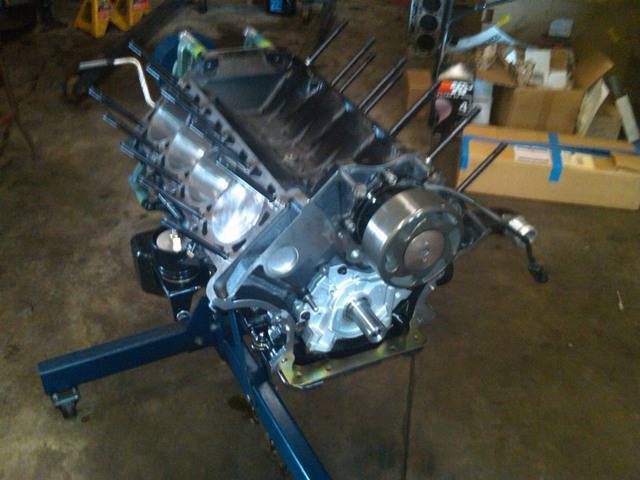

Coincidentally, the shortblock is done and will be picked up this week.
The car itself is a bit behind schedule. I'm hoping to have everything done by the end of July, including the new motor.
