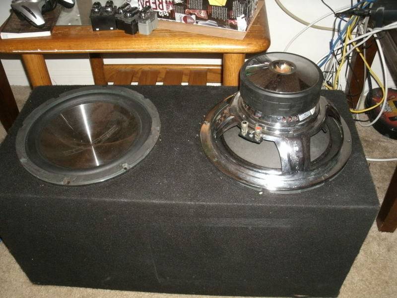

I'll be using my old Pioneer H/U until I find one I want and can afford. I also have 2 12'' Eclipse SW6123.4 subs in a sealed 2 cube per chamber enclosure I'll be using as well because I love them and they've been with me through 3 or 4 cars. Expect new updates on Sunday/Monday.

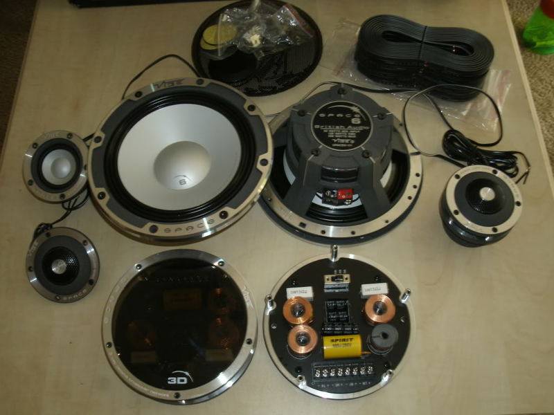

2 sets of these: http://www.sonicelectronix.com/item_31676_VIBE-Audio-SPACE6.html
Review for them if you never have heard of the brand... http://www.talkaudio.co.uk/index.php/index.html/_/reviews/speakers/vibe-space-3d-r343

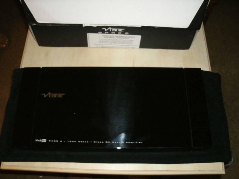

And a: http://www.sonicelectronix.com/item_31680_VIBE-Audio-BlackBox-BASS4.html
Plus my existing subwoofers:

I hear nothing but good from every place I see vibe amps and remember, the sub amp is Class GH so it's pretty efficient, I'm not sure, but I am pretty optimistic about 100RMSx4 and 900RMSx1 I have seen lots of reviews and spent alot of time tracking down people who spent time testing the amps and they claim they meet or exceed spec. Here's a crappy youtube vid, but he's setting the gain on an identical amp, you can see the scope screen and 20v, he has the basics right too I think. The way I've learned, volts x (volts/ohms)= watts -so- 20x(20/4)=100 = Rated power. Unless I am mistaken, and I am rusty. Seriously, stranger things have happened, and that pic of the internals is pretty crappy.
Here's a review that's favorable... http://www.talkaudio.co.uk/index.php/index.html/_/reviews/amplifiers/vibe-blackbox-stereo-4-r838

I have no energy at this hour to open up the heavy ass bass amp now, but I will and then compare. But I spent a while learning about class G/H and they are pretty damn efficient.
http://www.apsdc.com/Amplifiers Topologies,Class GH.htm for some basics.

The speakers look nice but them and the x-overs are big for the sake of being big. Not a fan of stuff thats bulky just so it looks more substantial.

The speakers have me curious though. The xmax on the midbass looks limited due to the surround design but they may be very tight and clean from 100hz-300hz. I like the three way setup but you are gonna need an EQ. Systems like that tend to be very bright at 2000-3500hz.

Anyway, I have heard the speakers first hand, and they do sound fine, bass extension is good too, remember the aluminum cones are very light and quick. I am researching decks and seperate EQs for the sake of wanting one, but I did some playing around and I was very happy with the nutrality of the speakers with only minor issues with brawny upper mids which were actually easily dulled by running the speakers in the "3D" configuration. It really did disperse well and help curb the edge I heard.
