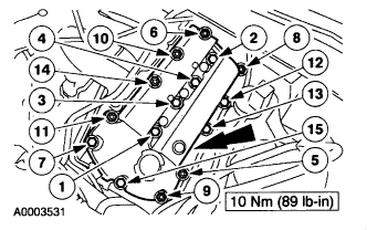

    I broke the number 9 bolt Joegr

    I meant valve cover bolt in my original response. I never broke any intake bolts... I messed up when replying Joegr my bad lol.. I just realized I messed up when I looked up the part number

    All of those are still available.
    3W4Z-6C520-BA, bolt with spacer - this should be the one you need, still made
    3W4Z-6C520-CA, bolt with spacer and stud - like the one used to hold the dipstick tube, may be hard to get now
