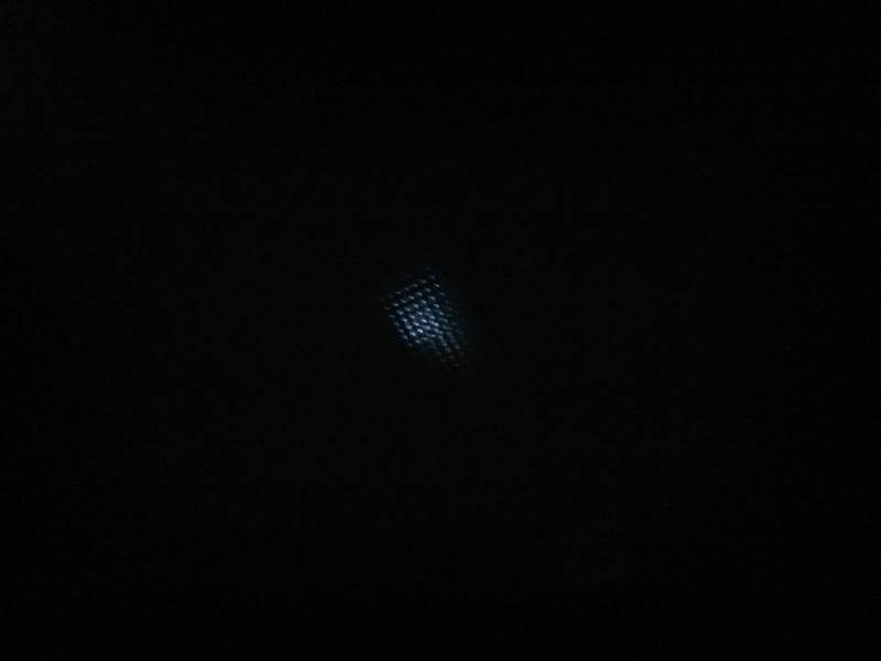

So, heres my issue. My battery seems to drain in about 12-15 hours to the point where it cant start the car. This started happening maybe 2 weeks ago. The battery can be charged just fine, there just seems to be some sort of drain. Now I installed LEDs in the interior and the license plate a few months ago. I've noticed they dont completely turn off as you can see in this picture:

If Im not mistaken those LEDs stay sort of lit for like 20mins or so. Theres threads on that.
Yeah I believe that is true. I believe the car goes into 'sleep' mode after 30 or so minutes and they go off. I am going to double check in a few more minutes (just got home like 20 minutes ago). But if my car isnt going into sleep mode like I suspect then that might be an indication
the LS has the interior lights that dim right? instead of just going out?
cuz if so, that is probably accomplished with capacitors. its easy to do, i've built the dimming circuits before. but the low power LEDs take a lot longer to fully discharge the capacitors. takes a while for them to go out completely. so they glow.
i don't think its a problem.

Yeah after sitting over night the LEDs were still on. I don't think its the lights draining the battery though because they have been installed for months with no problems

The LEDs are not your problem. Your problem is that your car isn't sleeping. Unfortunately, the reason for that may be difficult to track down.
A little note about the LEDs glowing. The glow is from the slight amount of current that the bulb minder circuit uses to determine if a bulb is burnt-out, and from leakage from the electronics. The regular bulbs use/waste even more current than the LEDs, but the LEDs are so efficient that they can actually produce some light with the waste current. If you were to put regular bulbs back in, the parasitic drain current would actually increase even though the bulbs wouldn't light up.
This was my thought about the slight glow from the LEDs. Thats why I wasnt worried about it till this junk started happening. Thanks for clarification as to the exact reason its happening though.
