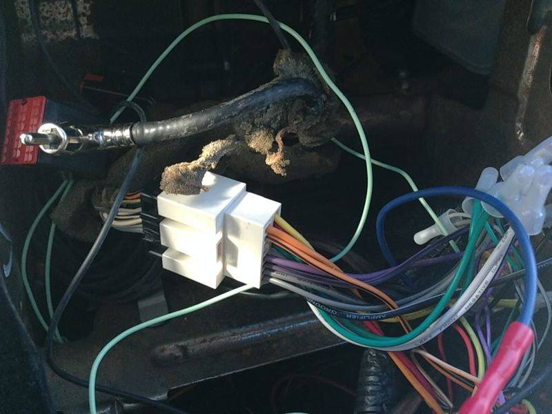

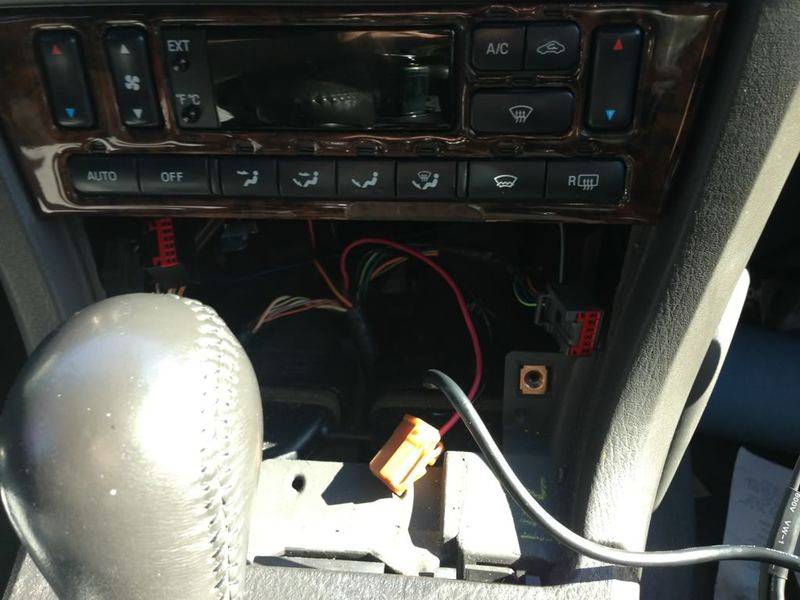

Ok so I'm heading out to (mostly) uninstall my AR2 ill have pictures of it and ill put them in reverse order so we can all pretend its a brand new install.

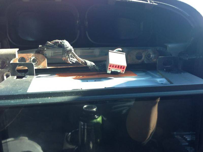

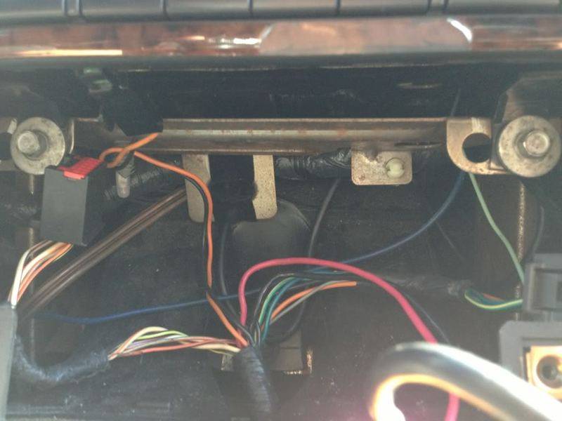

First take off the lower cig/seat warmer panel by popping off the trim panel and unscrewing the two hex heads
The under the a/c panel are two more screws
The upper a/c vents will need to come out as well but are an easy removal and I went ahead and disconnected those buttons as well

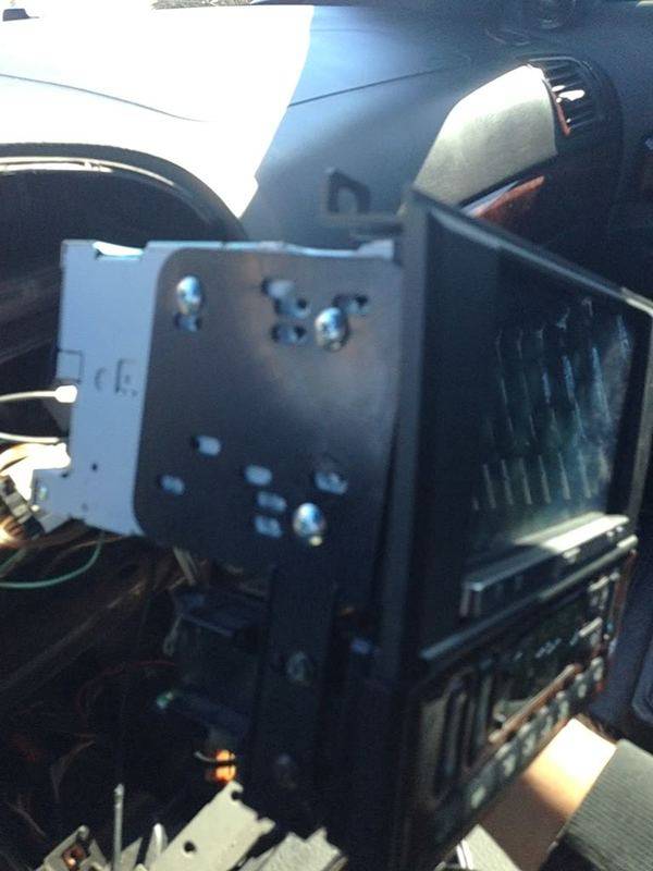

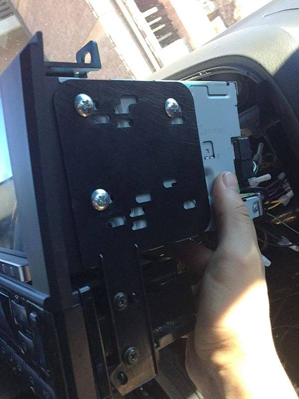

The radio bezel comes with 2 mounting plates that will replace the metal ones that come stock in the car. These will fit on the side of the radio and the a/c console section

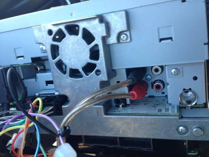

Now for the back Side of the radio
The wire adapter piece
Right side of the photo contains the antennae input and amp outs
Sorry that this pic is a little blurry but

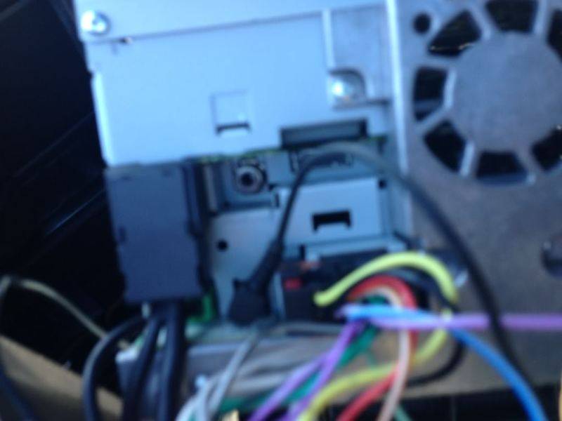

The speaker input . The larger black plug to the very left is the iPod connect. The Small black wire with the green border on the end it the GPS receiver. Small black thin wire more center is the mic input . The slot in the top right of that small group in the hdmi for android phones.
The install is pretty simple just make sure you disconnect the battery ground so you don't blow a fuse and waste time double checking wire splices
The only part that was different than usual radio installs was replacing the metal internal plates with the plastic mounts
Yeah dude thanks for taking it out and showing us the process! I think I've decided to use my tax return to get everything I need and have 1Loud do the install since he works at the local best buy in the car audio center. I know he'll do a real good professional job, and of course he knows the LS so yeah lol
