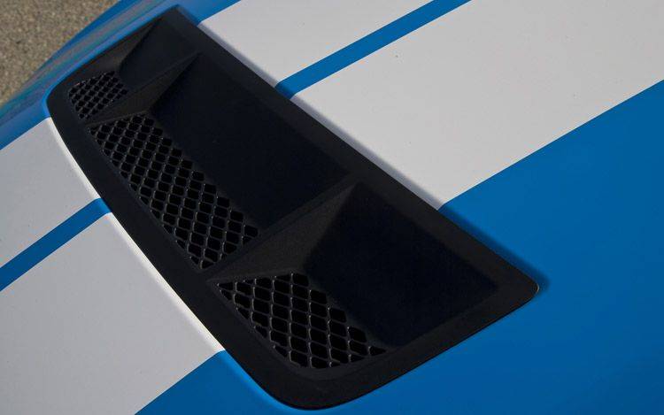

this would be easier...

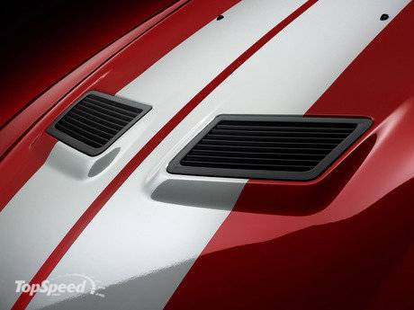

And its only like $60 IIRC, I like the twin vents on the 05'? GT500 but those are $98
And in your previouse post, I didnt realize your vents were that large, must work pretty well.

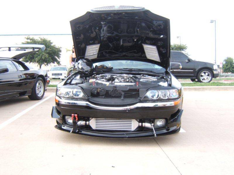

I like the shelby vents - since they are more about allowing the air flowing through the radiator to escape freely (instead of creating a high-pressure zone in front of the engine) - so the flow will improve.
The only reason I did vents in because the roots blower cap reaches 280 degrees and I wanted to allow from some better cooling. Stock engines really don't need it.
