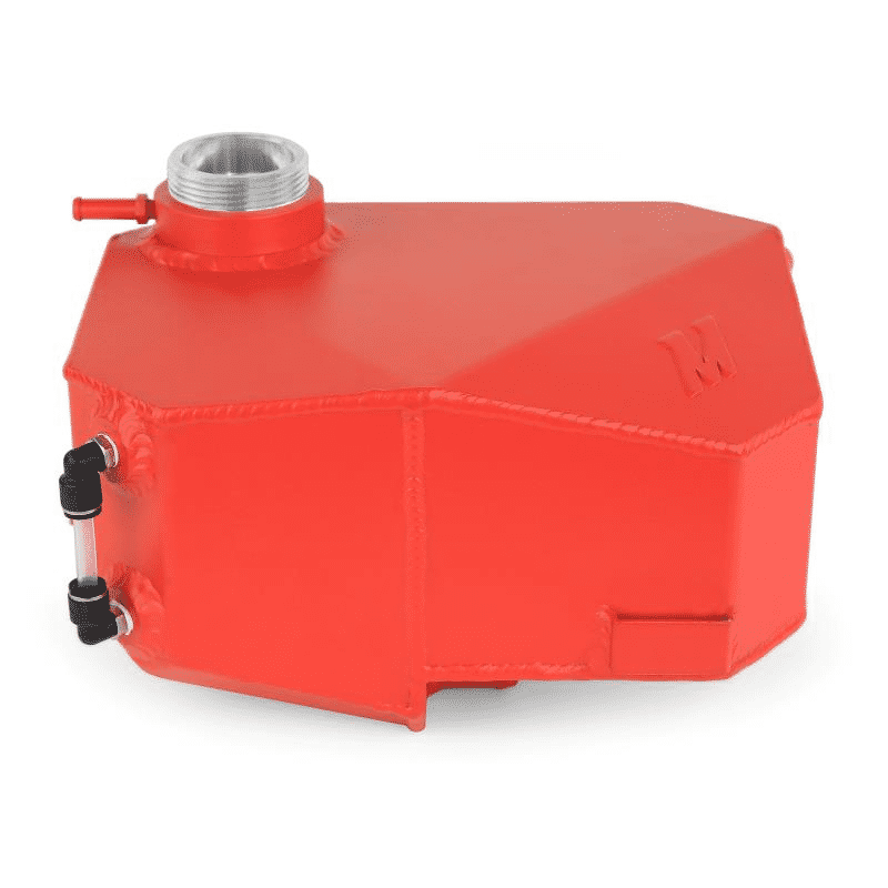

        Anyone in contact with aron apple?
      • Stinkin lincoln 1
        Stinkin lincoln 1 New LVC Member
        Messages:
        Likes Received:
        Joined:
        Jul 17, 2016
        Location:
        Orlando

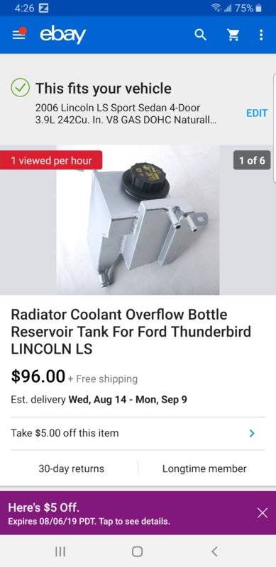

        Thoughts?
      • lincolnfam
        lincolnfam LVC Member
        Messages:
        11
        Likes Received:
        Joined:
        Jan 31, 2019
        Location:
        socal
        any sight glass on that?
