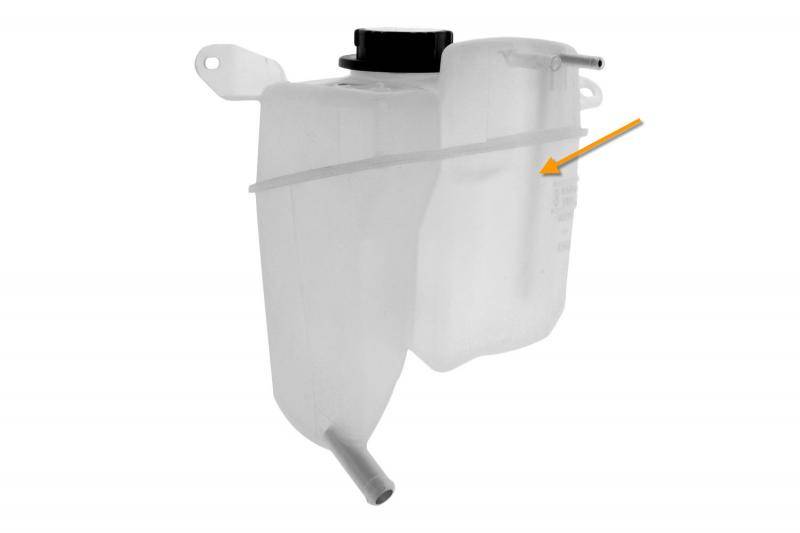

I guess this is the tube Joe is speaking of....

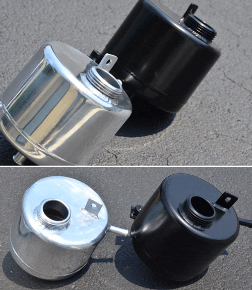

And on another note, it's been suggested that an adaptation of an existing item would be the simplest answer. Such an item may end up costing less than $100 and require only minimal work to create a mount. Long 'worm-drive' SS clamps come to mind!

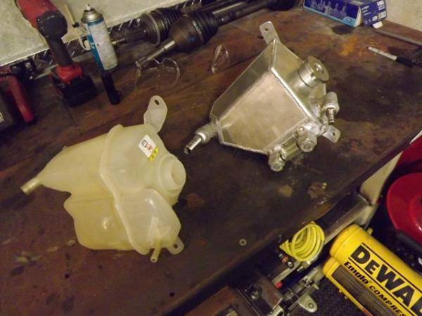

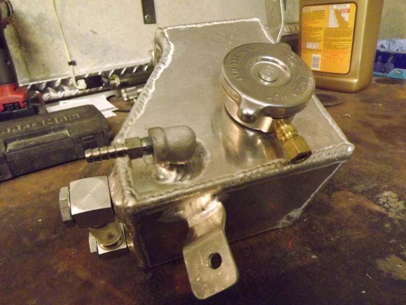

I have made an aluminum degas bottle and have been using it for quite a while. It works great but the sight tube I put on the side fogged up so I cant see the level. I made it very close in shape and size to the origional bottle.

Since I started this thread I believe I've found an existing aluminium item that might well be adapted to fit. What I have in mind will not require any tig. When I'm sure my idea can be made to work I'll post details here. You won't be able to adapt it while sitting in your living room but It won't take a fabricating shop either.
