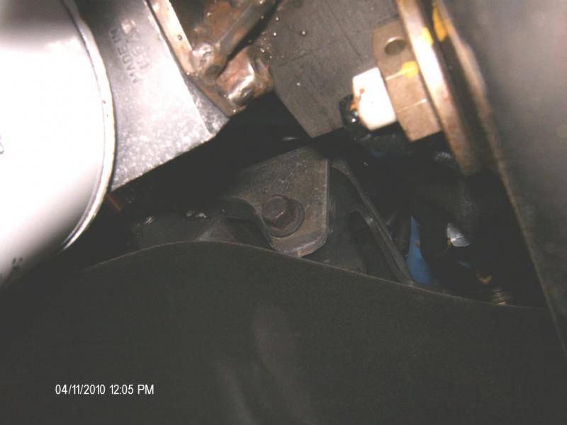

Since you didn't mention it, are we to assume that you've removed the driver's side motor mount through bolt?
.....it's just in front of the steering knuckle....

If you were able to move the pass side, that mount is probably shot! :eek:
Look up from the bottom, just behind the K-Member, and you'll see the through bolt in the mount. :cool:

If you decide to remove it, here's a pic of the through bolt in the driver's side mount.
If I detach it will it be a pita to center again? Which one of the bolts in that pic is the through bolt the black one or the gold one?
