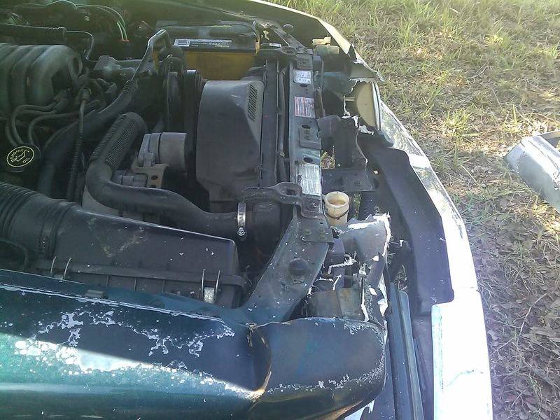

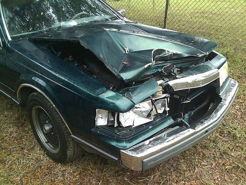

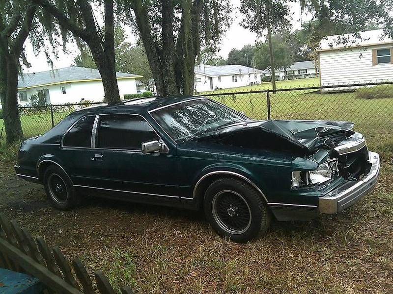

Its a 92 Deep Jewel Green LSC with a sunroof and theft system options. It was a pretty nice ride until my neighbors 16 year old son wrecked it. It was his dads car. He said he was going to part it out but I couldn't let that happen. I had driven it a few times and knew it was pretty darn tight for 171,XXX on the clock. Here are some pictures from before and after getting it back straight.
Before.
Core support is untouched.

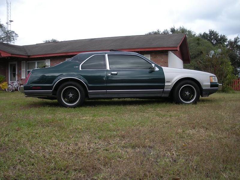

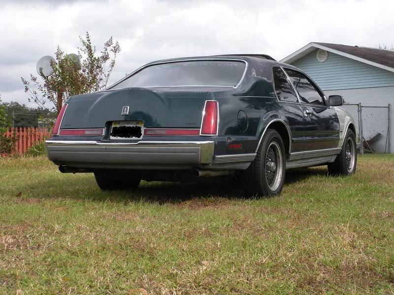

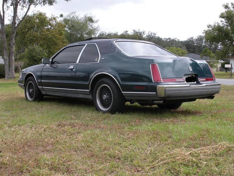

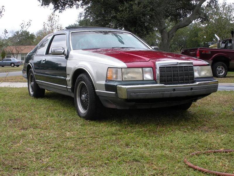

After.
Still needs a few more tweaks to get all the seams equaled out around the hood before the re-paint.
What do you all think of the black wheels? I like it especially with the green.
Black wheels and dark green paint are a very good combination!
Progress of the car looks good, also.

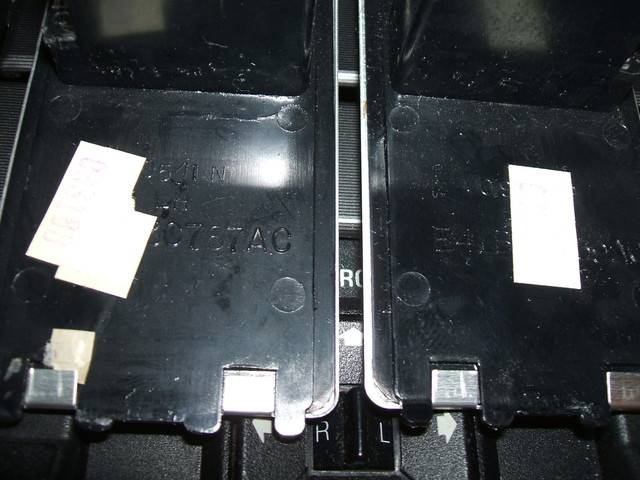

You will need a small flat tip and a number 2 phillips.
Read the following thoroughly before proceeding.
When looking up at the lenses of the map lights you will see a small slot in the surrounding black plastic that is in the vertical position nearest the on/off button. You can only see the slot if you are looking almost toward the rear of the car. Once you find it carefully place the flat tip through the slot and gently push in about a 1/16th of inch or just enough to release the clip that holds the entire lens assembly (lens and the black aluminum trim around it and the button.) Easy way to know when it releases is to pry down slightly on the assembly just behind the button while pushing in gently on the tab through the slot until it lets go.
Doing this any other way will almost always break the tab and the lenses won't stay up in place anymore.
After all that, use the same small flat tip to gently back out the multi pin connectors on each side. After that remove the four phillips screws. (I think they are right next to the lamp reflectors, two on either side.) Then pull down and forward on the rest of the unit. Be careful of the fabric in the corners as it will tear very easily.
Good Luck!
