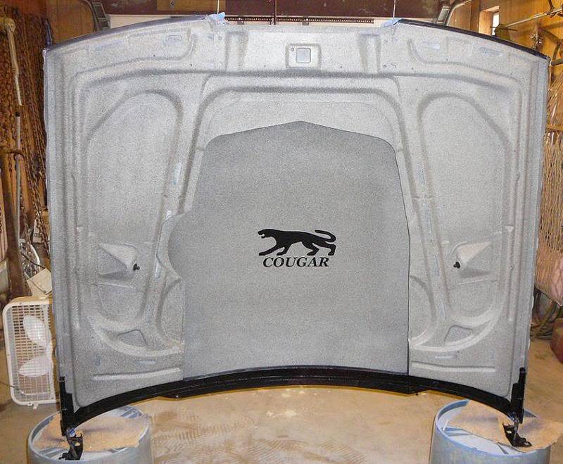

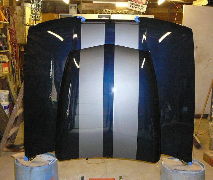

I like the looks of that setup and also like seeing someone that knows how to make a cold air box. Conical air filters are useless when the correct box ain't there for it. Yours looks damn good. Any pics of the hood? Cut outs?
Thanks. There is more to that airbox than you can see from the outside. The filter is sealed off using large foam-rubber weatherstrip type material.
The hood is all sheetmetal. The scoop was necessary to clear the SC and intake tube.

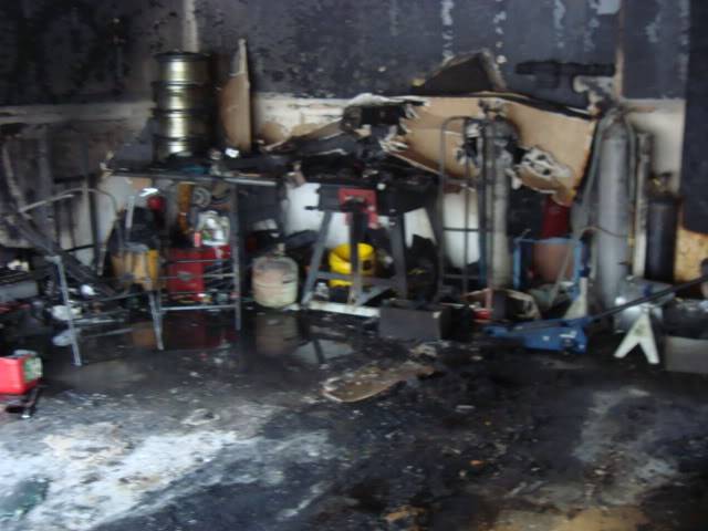

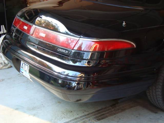

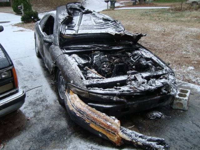

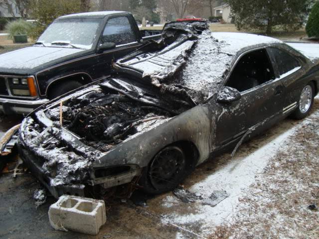

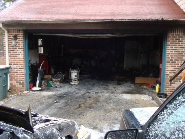

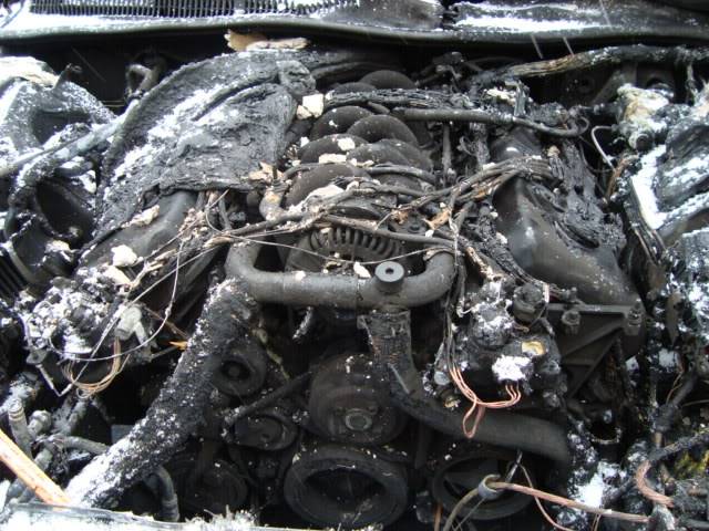

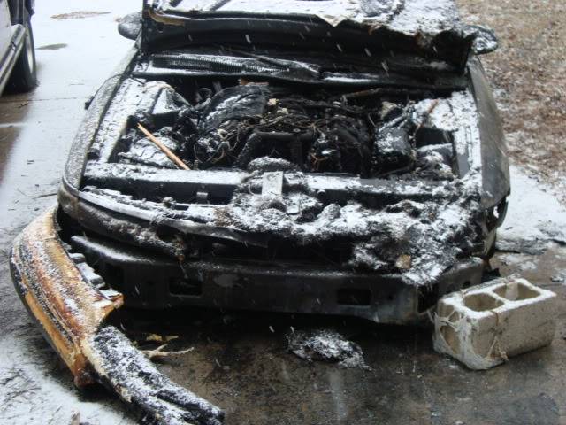

Last time I done anything with an engine was when I swapped out four fuel injectors and I wished I had never messed with them. It was my stupidity for not checking for leaks but I had left one of the o-rings off of one injector and blew the whole front end of the car off, inside the garage. If anyone had been inside the garage or if I would have had my windows down while the car was running, I would have been burnt badly, if not killed. Anyone in front of the car would have died. I thought I had them in right and I was in a hurry. Shut the hood, cranked it up and it was shuddering real bad and I gassed it a few times, thinking that I needed pressure at the rail for it to run right but during the time it was running, gas was pouring all over my intake and down the sides of the motor and onto the floor and then as I went to shut it off, something electrical ignites the gas and I thought I was dead. I only ended up with a cut on my leg from diving out onto the driveway and landing in glass. I got a few pics for you. Keep in mind, I was finally done with the car. I had just put in a 98 trans that I j-modded and only had 68K on it. Just painted most of the car and was almost completely done with an LSC conversion. This was a 94 black on black.

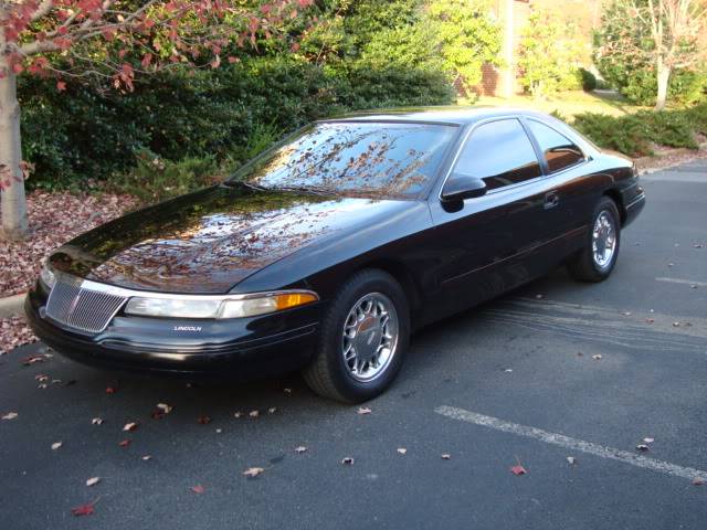

Before any LSC conversion

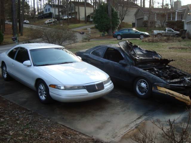

After but still not complete and dirty in these pics.

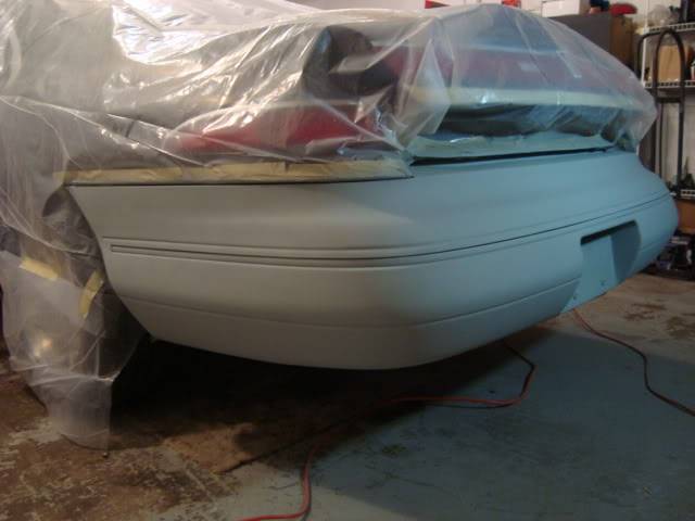

Was about to do some painting

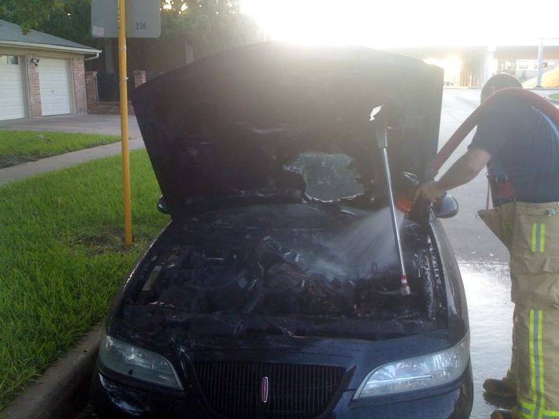

and I painted the top too all around the moon roof and then I ended up with this one night at around 11:30 all because I didn't check for a leak. Liability insurance only so the whole car was a loss and thousands of dollars worth of tools in the garage were also a loss. welder, saws, the list goes on and on with the garage loss.
All in 3 minutes, this is what I ended up with. That night sucked. So... engine mods just aren't on the top of my list. All I would do is end up with a ticket around where I live and I know me. I would never be fast enough and I would keep adding and adding. btw, I rent the house and did not have renters insurance either. Everything was a complete loss all because of one 10 cent o-ring that I was missing and didn't know it. I bought another one within a week or two and still doing little things to this one but I have already put all new lenses and grille on the front to get a newer look and I was able to save the interior from the 94 to put into the 95 for the two tone look. It just needed to be wiped off and cleaned a little. I now have renters insurance and a new garage with 90% less clutter and it even has carpet laid down in it. The 95 never see's rain unless I am caught out in it which is extremely rare.

Got lucky and not the first burn on me at all. Just one cut on the right leg and that's it. I keep a fire extinguisher inside the car with me now, just in case but not even that would have helped that night. It over powered me and the heat was just too much inside. I went back in with one but it didn't phase that fire. The fire dept. was called by the lady across the street and they were here within 3 min and soaking the whole car down and everything in the garage. If the fire didn't ruin everything, they did with all that water. They then pushed it out in the driveway just in case it decided to ignite again. It snowed that night for the first time in years. People from 10 houses away heard the explosion and came walking down the road to see if everything was ok. After you have been inside a car that has done this, you would never have a full understanding of what it feels like. Me and injectors just don't speak anymore lol.
