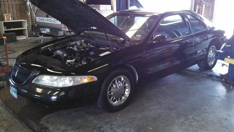

I think 1300 is steep for a bad car. Hell this one was only a grand and its engine and trans works great as does the AC.
