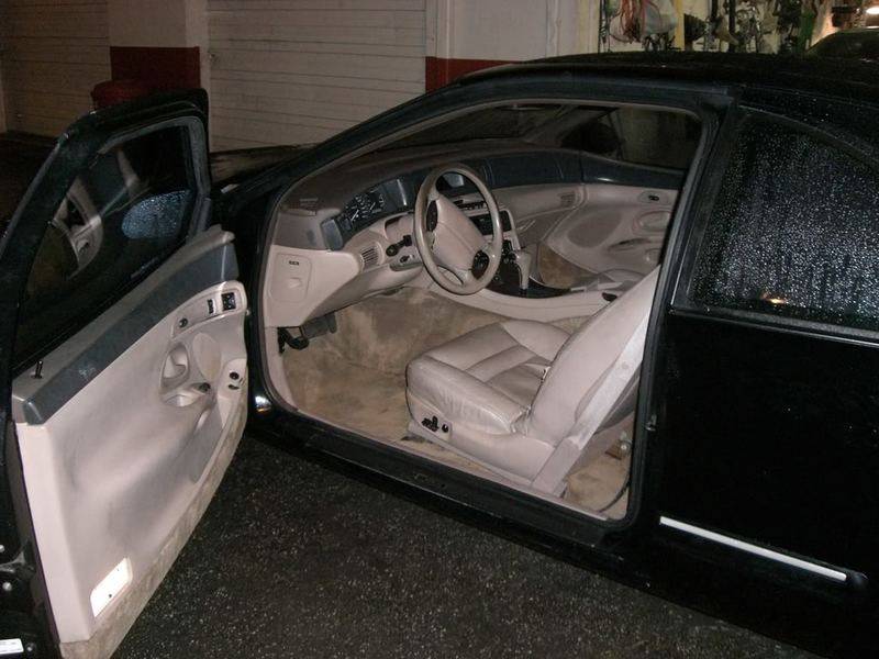

94 Mark VIII Interior facelift Progress

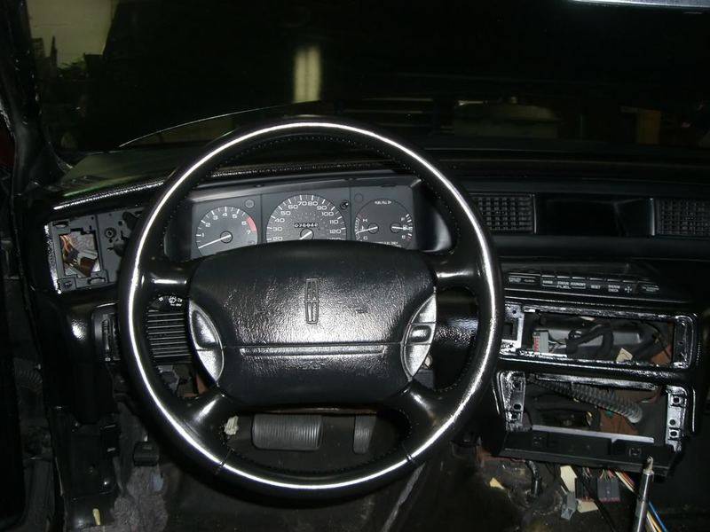

Some more progress...
It looks reallllly awesome, I went outside like 3 different times just to go sit and look at it.
Lemme know whatcha think. I can't wait to get the headliner re done black.
as much as saddle makes me want to lay in front of a train, it looks pretty dam decent dude, its honestly not that bad!

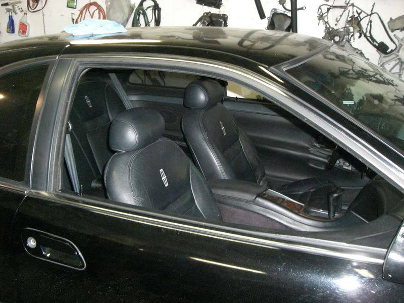

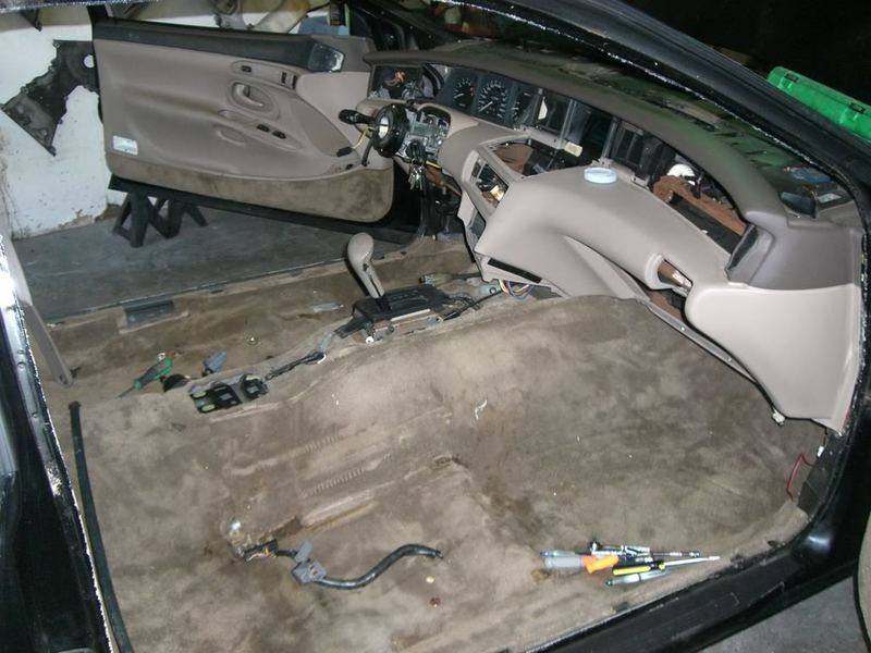

I happen to love it! Now I'm in the mood to continue mine... Guys what do you think about dyeing the beige carpet to black? I have a friend that did that to an Acura Integra he owned & his carpet looked brand new!

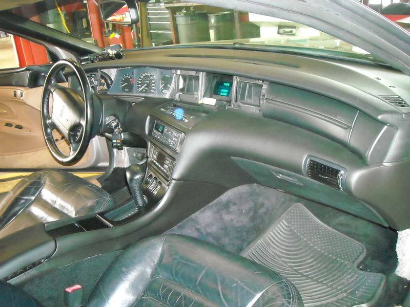

That looks damn nice!!
I'm inspired now.
Are you going to two tone the driver/passenger doors also? I'd love to see some examples before I get started.

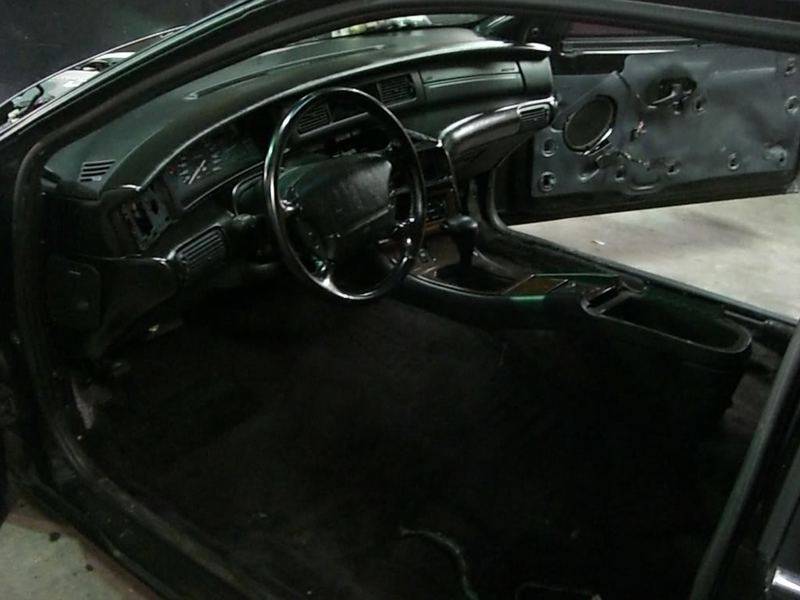

Well, here's an update...

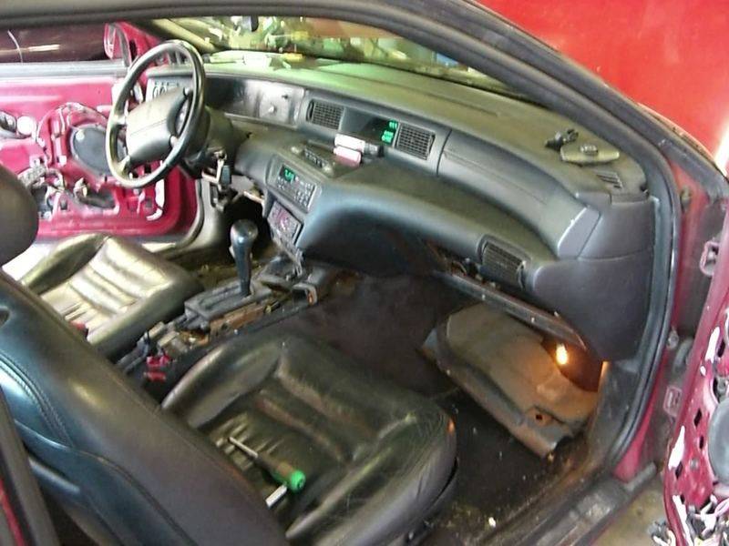

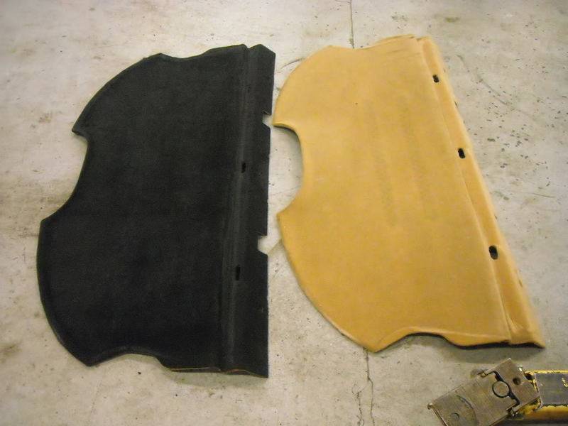

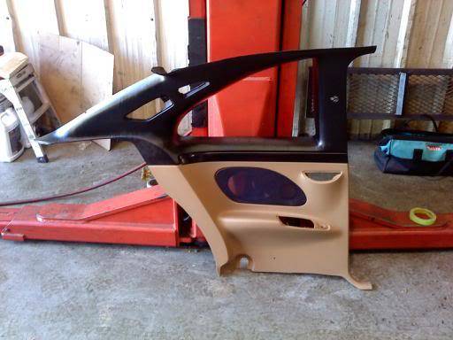

The paint that I used to paint that quarterpanel trim did something odd. I have used Krylon fusion for EVERYTHING I have painted for a year or 2 in this car and my old SHO. Anywho, this is the first time that the paint has stayed tacky in some spots. The majority of the peice that I painted dried and looks great, but on the opening around the window, there are sploches that look the same as the rest, but are tacky. SO, I made a last visit to my parts Mark at the pull a part. Picked up both rear quarter trim panels, the carpet under the back glass, black a/c vents, black glove box door, and a black fuse panel door. The entire interior now is going to be black. I am going to patiently wait fora set of black 2nd gen door panels to complete the swap and I am going to paint the lower section of the dash black.
My gripe with pullaparts is how many good parts get destroyed by idiots. There are 5 M8s in that yard, and all of them have the center console so F*cked up that the ashtray/cup holder assemblies were all broken. The black leather seat back that I personally tried to keep nice for anyone else coming along was lying under the car yesterday. Along with the mint black door panels that were destroyed because some idiot needed window motors.

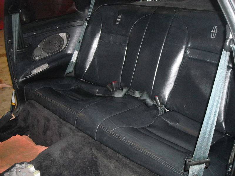

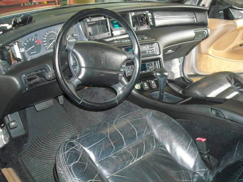

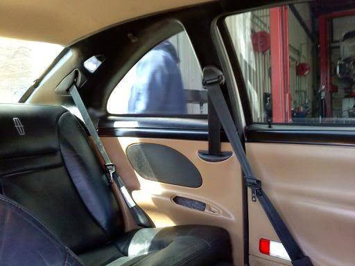

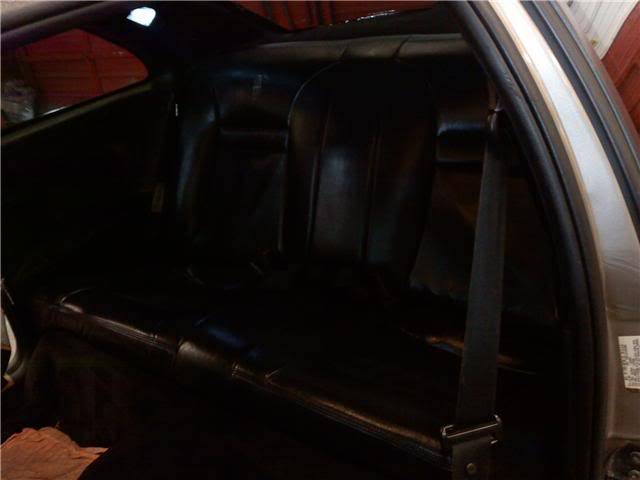

Well, I went back to the pullapart because I decided the 2 tone quarter trim panels werent going to work... Here is a shot now of the back seat...
Forgive the Cell phone pix.

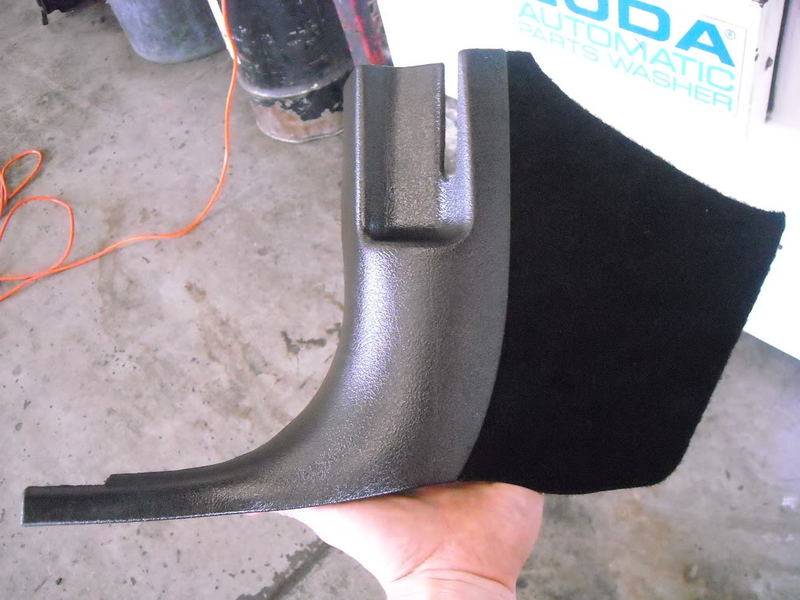

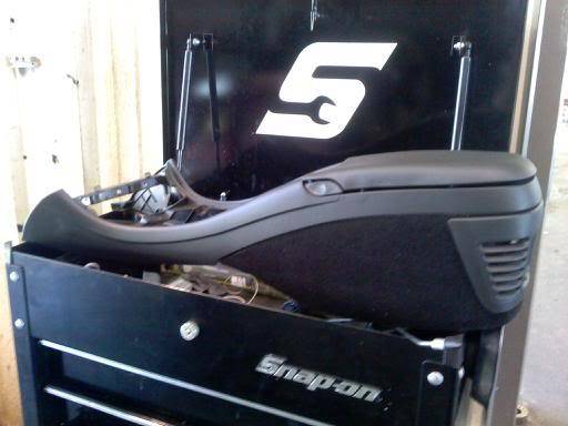

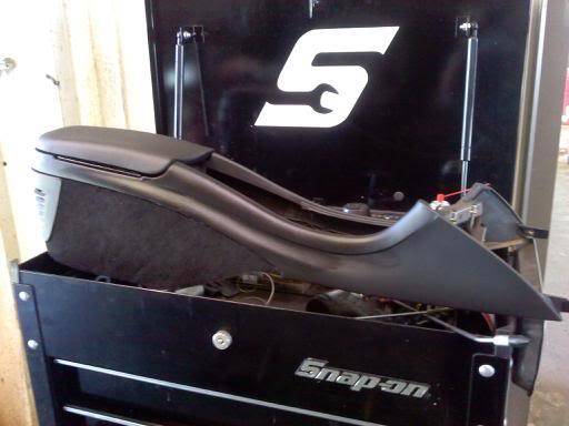

And here is the center console. I didnt take any before pictures but we all know how ugly a saddle center console looks. I used Rust-Oleum carpet and vinyl paint to paint the console. I completely dissassembled the console rivets and all. I am really anal about paint lines and stuff like that so, I made sure there werent any. I used carpet that I got at big lots to recover the sides of the console. If I didnt know better, I would think that this was a New Old Stock console. It looks amazing.
Its getting there. I am going to paint the dash on saturday. This paint works awesome. There were a couple of times I thought I put it on too thick but it just flowed out and looked flawless.
Dude after doing the same color combo on my seats & dash last year I had to continue & just finished going from beige to black carpet. HUGE difference! In the next couple days I'll be painting the quarter panels. I was inspired by you to do the 2 toned on the quarter panels, cant believe you ended up painting them all black!

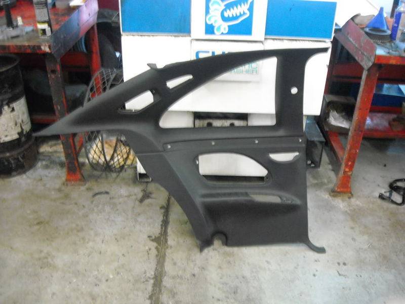

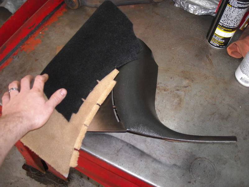

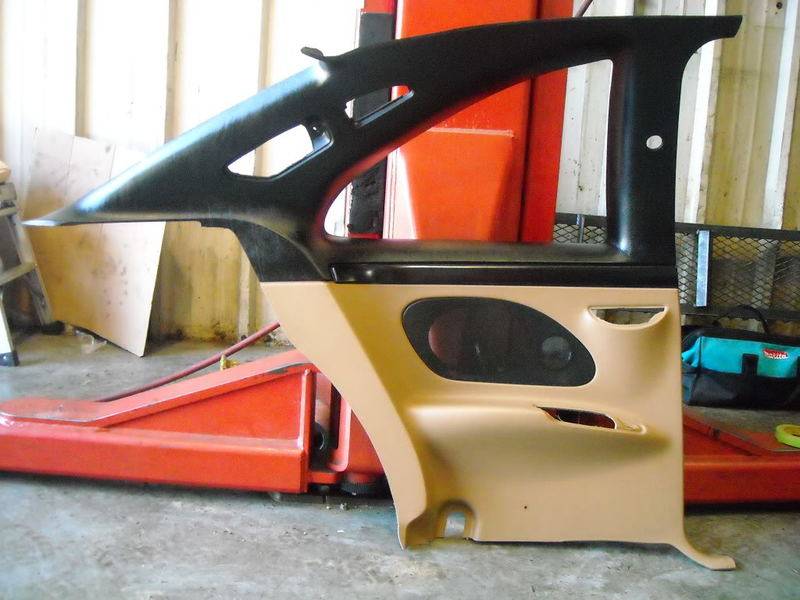

I didn't paint them all black... I should have used the paint that I used on the console on the quarter panel trim. The paint on the quarter trim stayed tacky and was too glossy even though it was satin paint. I still have the 2 toned quarter trims, but I went and bought all black ones, thats whats in the car now.

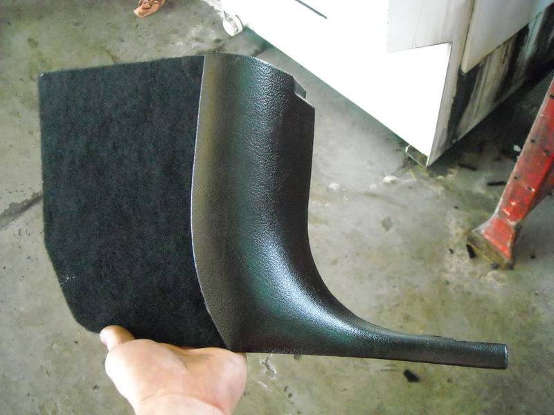

My old quarter trim.
My new quarter trim. These are OEM black panels.

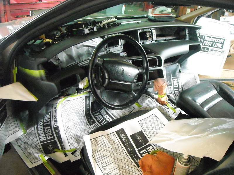

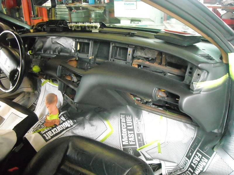

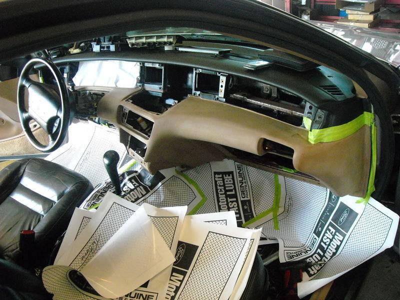

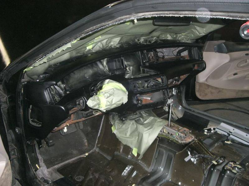

So, as for the front dash, I am a Ford Technician and a dash swap is easy sauce as I do stuff like this on a daily basis but I opted not to mess with my already perfect condition dash, so I painted it. I removed all of the dash components and wiped the whole thing down with paint thinner.
Masking...
More Masking...
Painting...
I like this vinyl paint because it really does look like black vinyl. It has a slightly dull finish. If you wait a day or so for its cure time and hit it with some protectant, it pops just like vinyl would.
Here is the dash mostly assembled.
And incase anyone was wondering, the steering wheel, steering column trim, a/c vent housings, glove box door, seatbelts, carpet, seat skins, quarter trim, and carpet under the back window are real black parts, everything else in the car has been painted.
