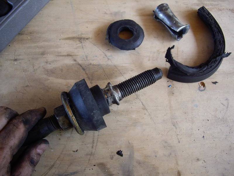

post the pic of how you switched them around, I am trying to figure out the correct way vs the way you did it first

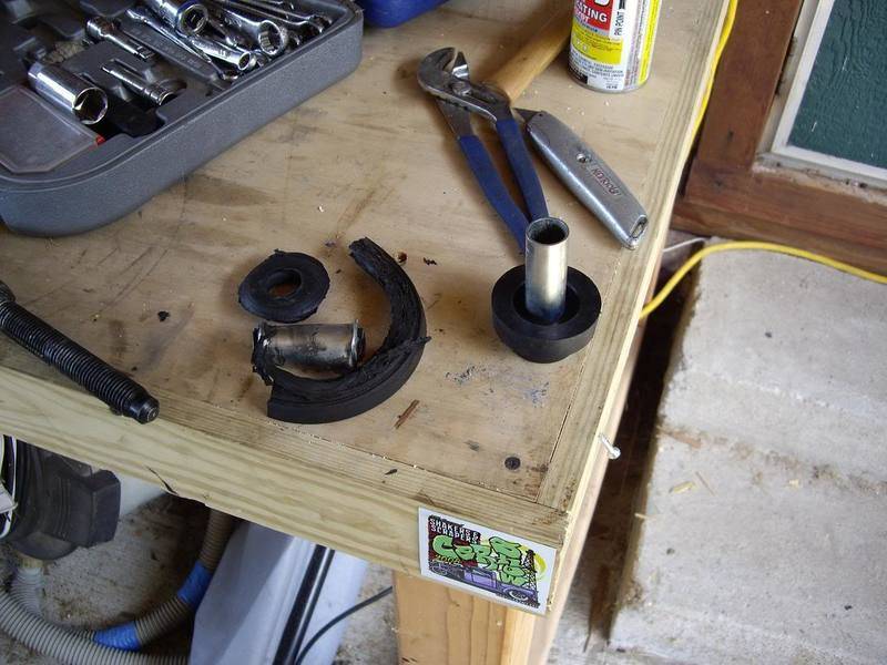

The way the previous owner did it is wrong. In this picture is the outer bushing but he made it the inner bushing.
So I installed it the same way. But alas it was wrong so you see that bushing does not go there. The inner bushing is the one sitting on my bench:

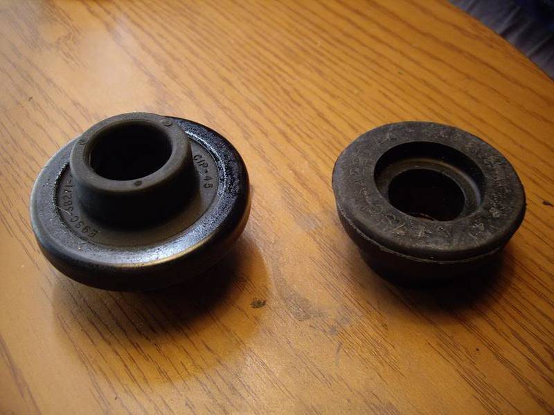

Now that is if you use the Duralast bushings. If you use the OEM ones they look a little different but they mount the same way.
