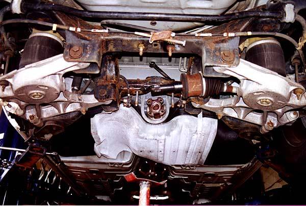

I dont know what that is, can you please explain? Sayin just take off one side hub off and then unbolt both half shafts and remove the c clips, remove one axle and for the other side just slide the pumpkin over after its all unbolted so you dont have to remove both side hubs?
If I take the pumpkin in I will need new axle shaft seals wont I? Also should I bother with the cover gasket or just use the grey silicon like I was planning on?
Heres a pic for clarity.

And thanks for the picture, that is exactly how I was picturing it. Do I need the tool to remove the half shaft from the knuckle or do I just unbolt the whole knuckle and slide it all out from the one side?
