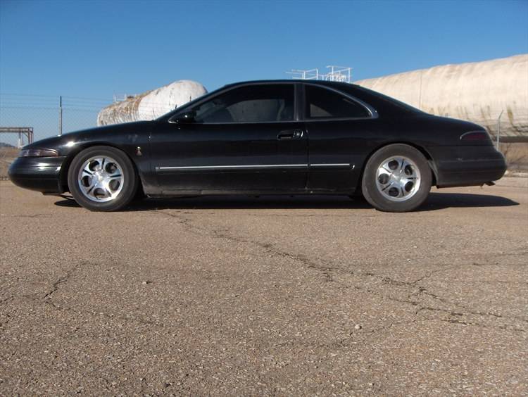

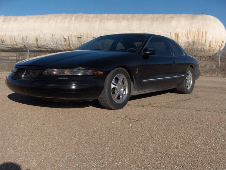

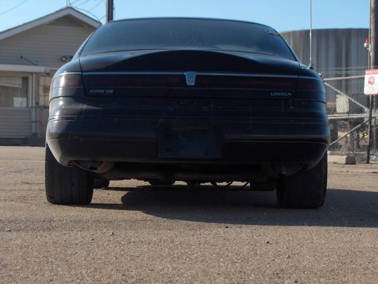

people were asking for more pics so here they are:
(Car's Dirty, the roads are still crappy)
Are those the same offset as a stock wheel? And I hope to see how much massaging it took. See you on the 20th.

thats awesome, how wide of a rim are those on? i hope im hoping to fit 285s or something similar on my LS(meh) wheels
That is killer man... your car looks just like what I want to make mine... smoked heads/tails, and all blacked out... very nice.
How tall is the over all tire?

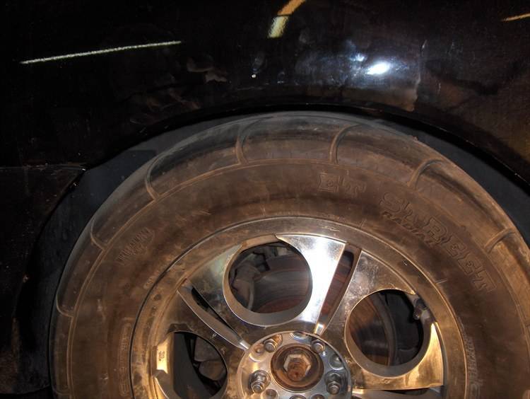

What exact fender stuff did you do?
They are 9" wide rims. I wish they were 11" wide. The tires are 27" tall.
I had to pull the fender out a little, grind down the flange on the inside of the fender, and massage the inner wheel well.
What brand are they? And what's the actual tread width and section width? They don't really look like 315s to me, especially if that's a 9" wheel. Look about the same as my 275s.
They don't look any wider then 275 BFG's on this car. I wonder if they're under sized like their 315's for 17 inch rim.
I don't know why you guys are trying to dis-credit me? I guess I'll post some FACTS for you...
My tires are 1.3" Wider Section Width, 1.2" Wider Tread Width, and 1.19" Taller in Diameter. So no matter how you look at it my 315s are bigger than 275s.
