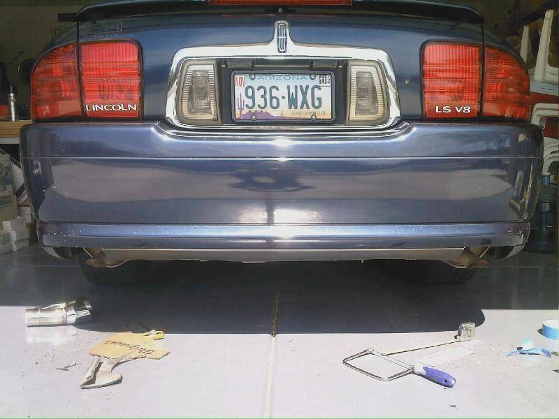

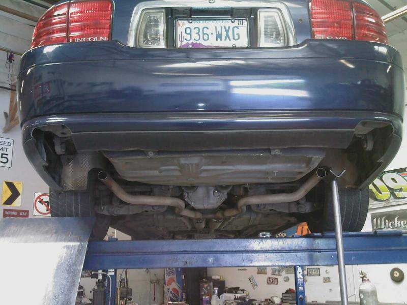

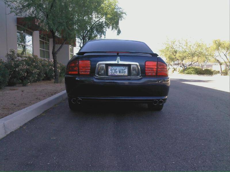

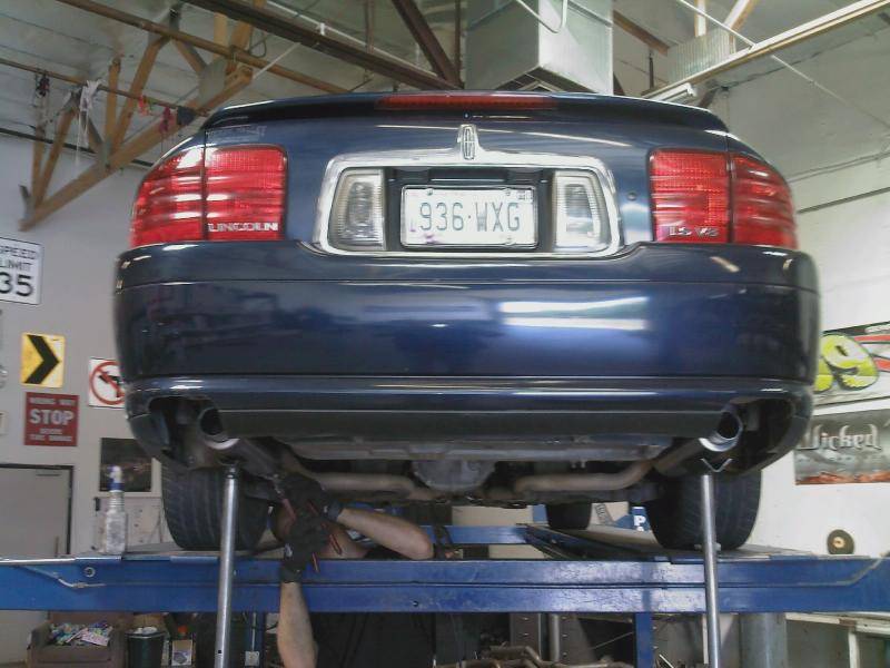

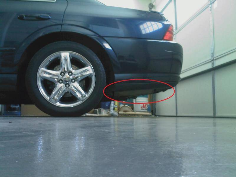

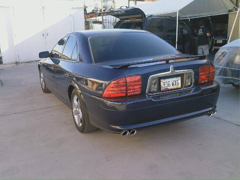

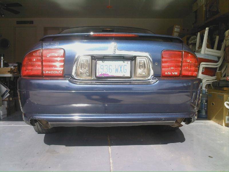

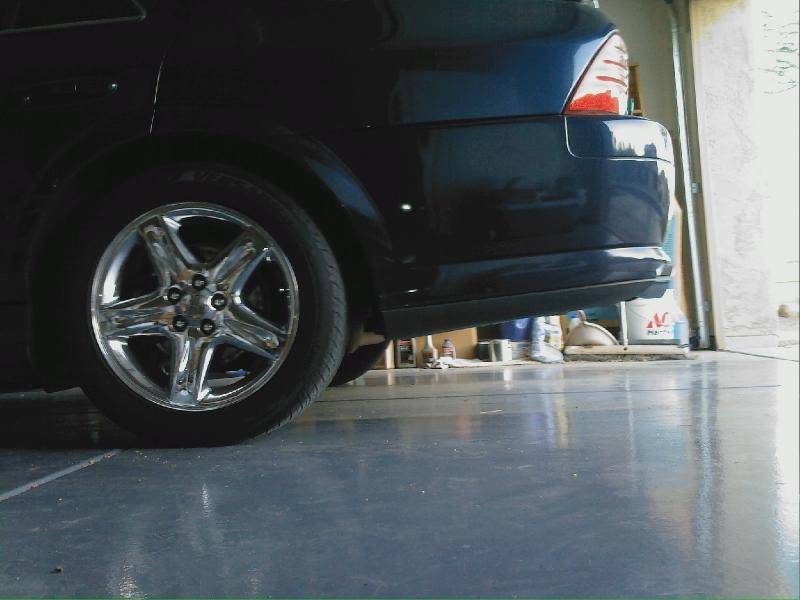

I needed to get some exhaust cut-outs done so I could get tips and mufflers installed before the bumper comes off for repair/paint.
Here is what I've done in the last week.
Before / During (Cut-Outs last weekend) / After (Mufflers & Tips installed today and a new license plate came in today too). I will probably take another 1/8 inch off all around after the bumper comes off before painting it. (I'll use a better camera instead of the cell phone for pictures after the body repair work).

That looks straight money.
When I first saw the cutouts being gigantic, I afraid you weren't putting in quad tips!
How you like the Bassani sound?
Thanks guys! It was a fun project to research, plan and execute!

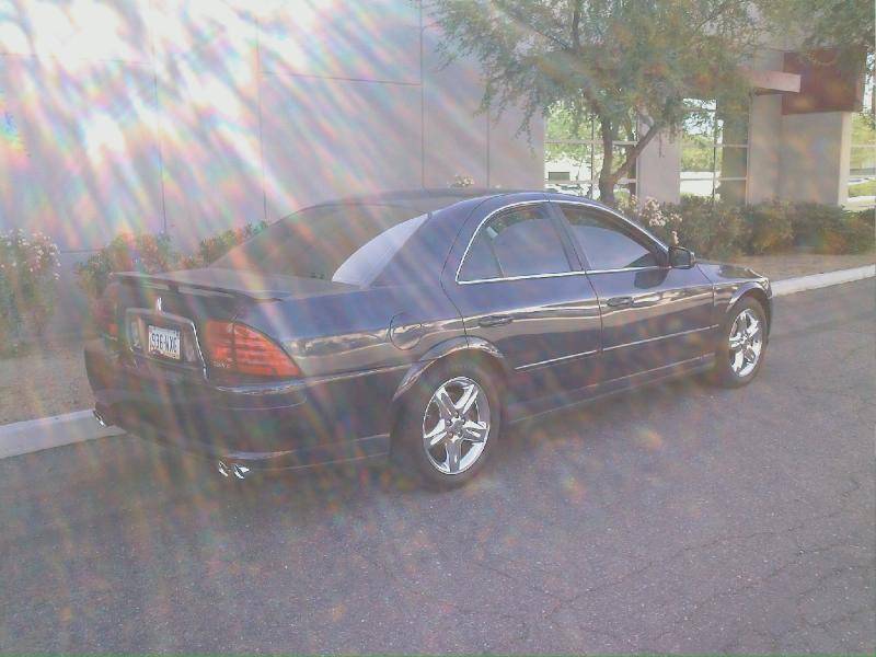

It was a great ride home! Had my foot in it 3 times... very cool. It's not loud at idle in the car, nor at cruise speed, and sounds good outside at idle. I stopped at a couple friends body shop on the way home today and before I got the car turned off one of them stopped what they were doing and started walking directly back to the rear of the car saying "What did you do?!!!". It was a nice afternoon!

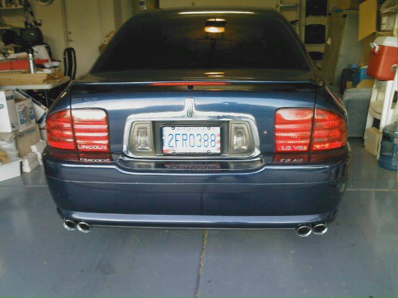

it looks great! i want to do the same thing but with single tips because i want my car too look luxury and i think dual tips (in your car) gives it a very nice sport style
I went back and forth between dual or single tips. Stopped at local shops looking at them, but they never had the single or dual tips I wanted. I decided on single many times, but kept coming back to dual outlets. '02 LSE had dual, and a few others on LVC had duals.

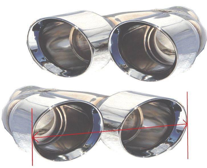

Measure your dual exhaust tip widths. I was going to leave 1/4" all around. Dimensions say it's 6.4" wide. So I was going to cut 7" wide.
Mine actually measured 6.25". Plus .25", plus .25" = 6.75" wide cut. Let's call this the "Wide Cut". (Measure your width, add .5" inches).

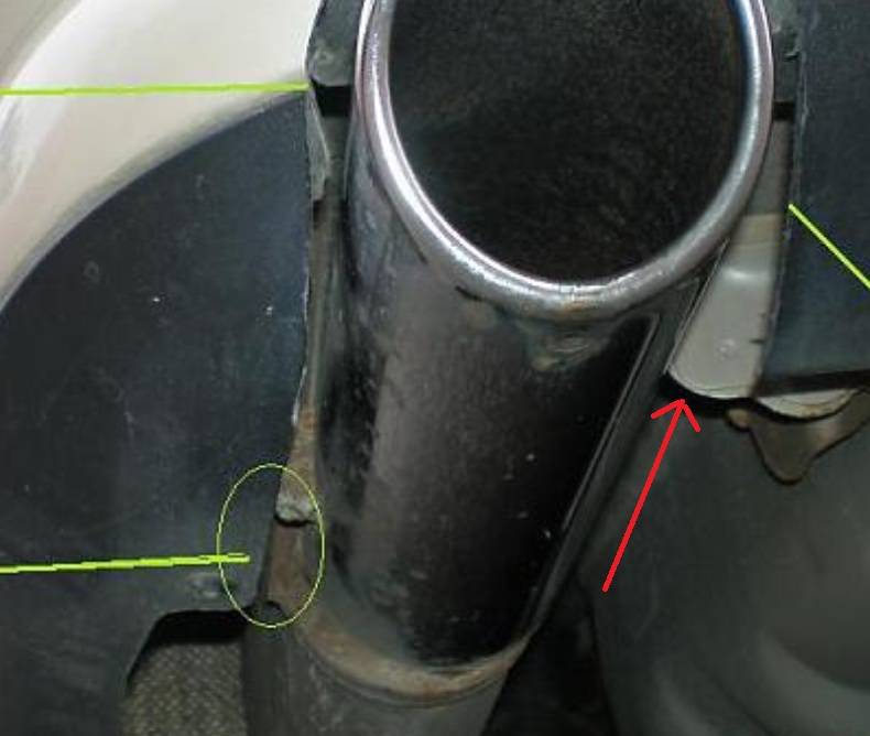

In this picture below where I drew a "RED" line is the "trunk mount" I am referring too... don't let your "Wide Cut" encroach/intrude towards that. Just start far left or right to the outsides of the valence/bumper cover when starting your initial measuring.
The exhaust tip picture below has red lines showing where the "trunk mount" will be very close to.
The Bassani #4820 muffler is 4" deep, 8" wide and 16" long. You will need a muffler within those dimensions or less, to get the tips high enough off the ground to tuck under/within the valence, to get the tips away from the trunk mount, and 16" or shorter so the tips don't stick out too far past the bumper. We actually angled the Bassani muffler diagonally up from the axle to the bumper so it follows the body line... you can't see it sticking under the bumper from the side of the car.
Last picture shows where to measure your exhaust tips for the "Wide Cut". Add .5" to give a .25" cutout border around the tips... (or just a bit more than .5" like .75"). I will probably be at .75" when done, to get another 1/8" more border.
