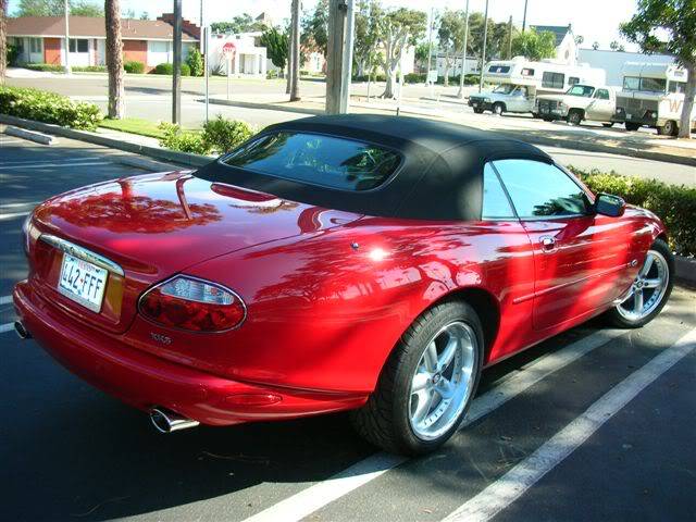

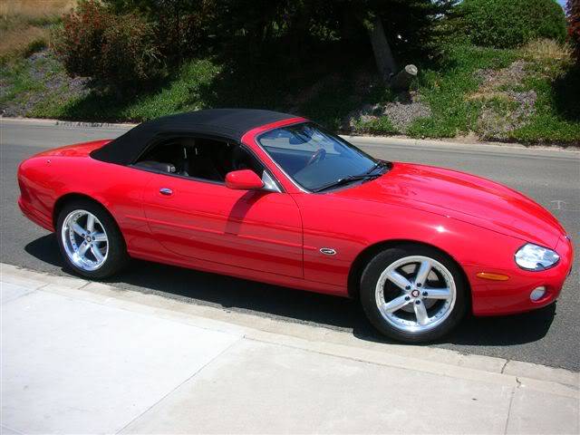

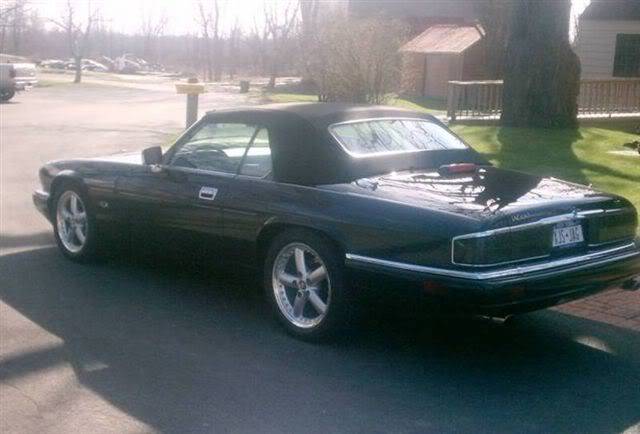

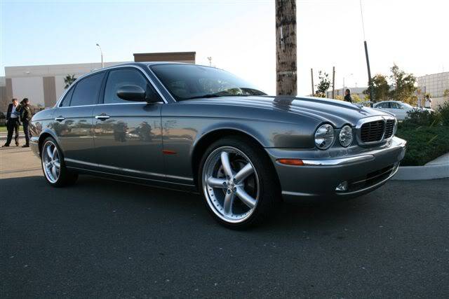

I think the first pic is a 20", the rest appear to be 18's.

weren't those the same ones i looked at last week or were they 19's? the image of them looks better than the picture with the rubber on them, i still like the ones you have already, though you said they're on the way out, the image looks fine polished and the oneson the jag look duller, maybe its just me.

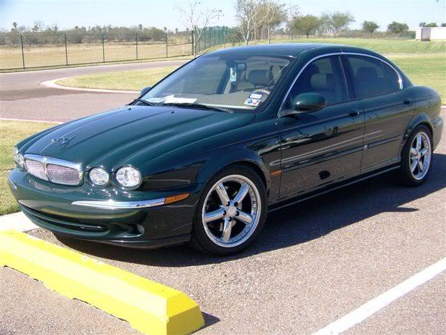

The ones last week were 18's. The first pic on the jag had a silver center but it was the only pic I could find for the 20's.
