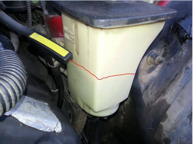

After cleaning and refilling the oil reservoir I can't find the leak source.

oil level

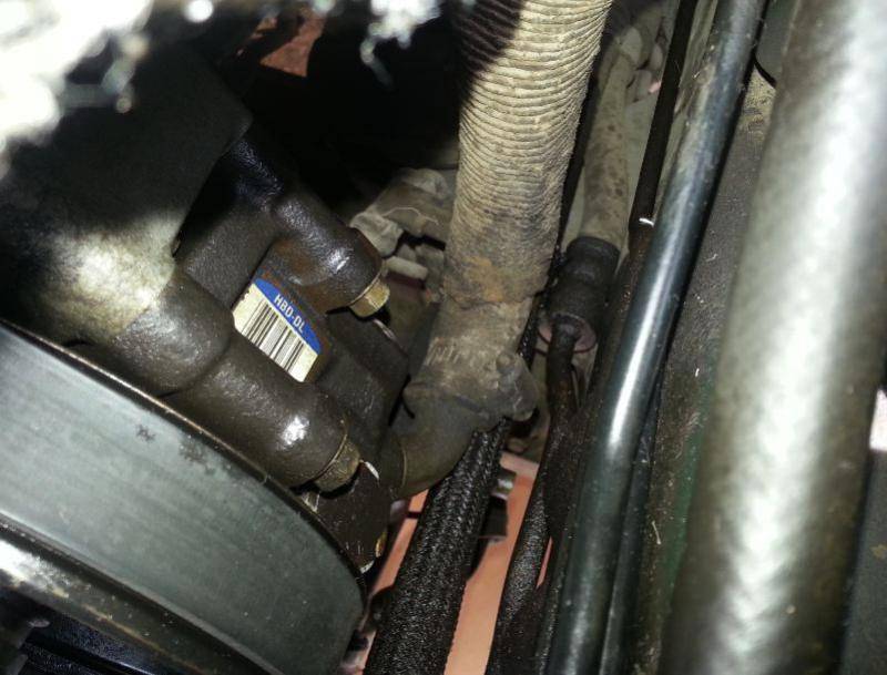

Under ps pump (ps pump above ac port)

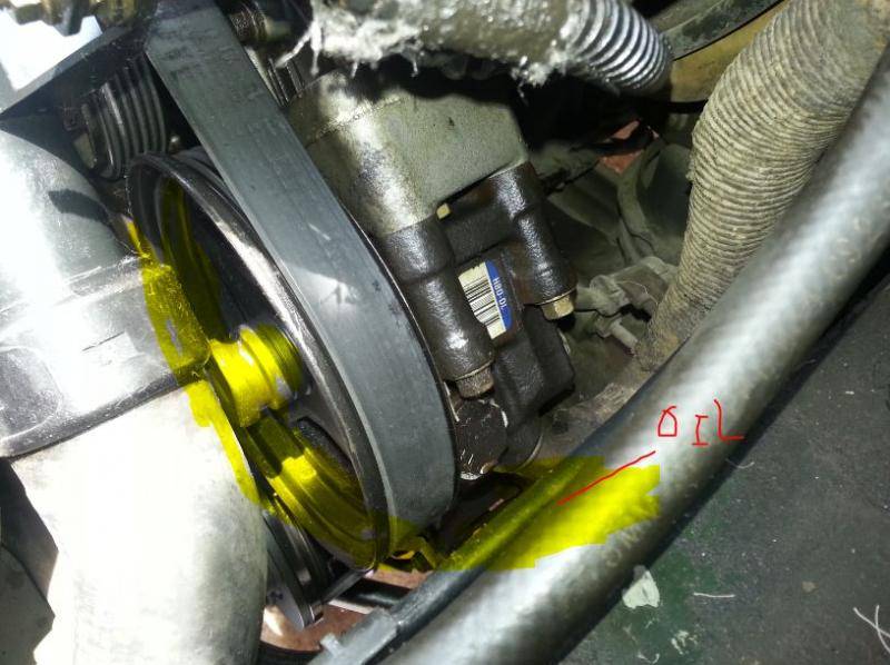

pulley covered by oil(yellow mark,i took the pic after cleaning.)

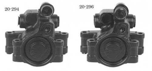

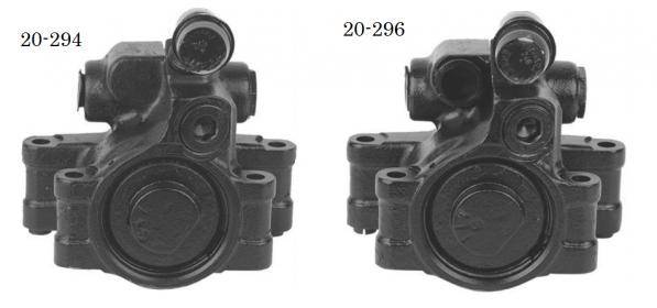

After some research looks that there are 2 types of ps pump , one which have the pressure switch on the back and the other one have the switch on the hose,i have this one.
So maybe the leak is coming from the fitting directly at the pump because the oil spills the pulley immediately .

It's probably either there or the shaft seal. Since it leaks when there is back pressure from the rack, it's more likely where the high pressure hose attaches to the pump. There's a hard seal there that may have failed.

Inspect the pspump again,(I clean all the mess before test,full oil reservoir)
joegr,as you said, maybe the shaft seal. very helpful,thank you!:)
Line hose OK
return hose ok

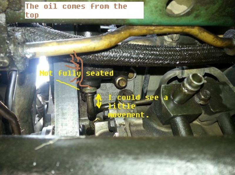

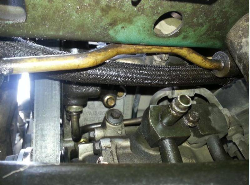

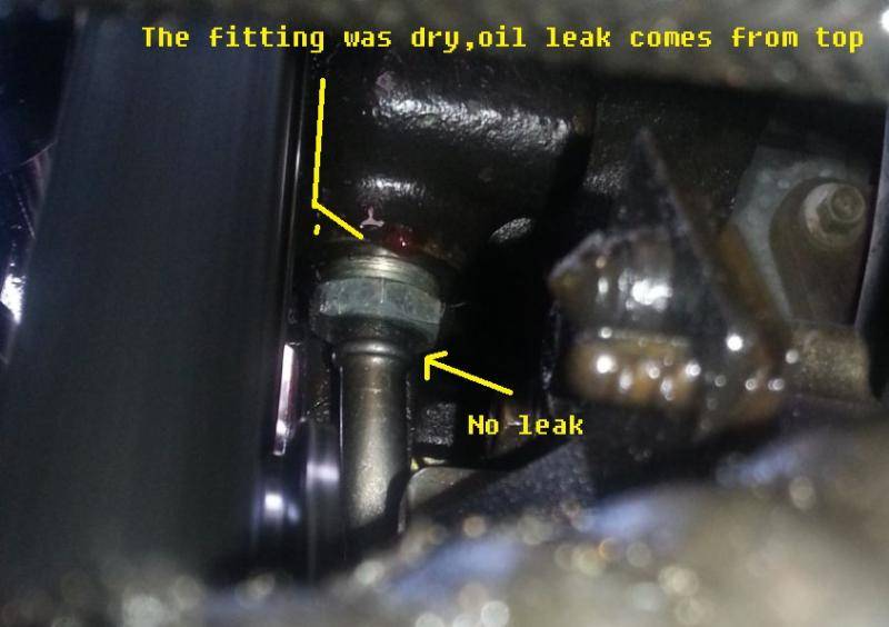

Pressure line OK but the fitting was not fully seated,I move the metal hose and i could watch a little wiggle between the metal hose and nut but not a leak.
After turning the car on i Could not see any leak at pressure fittings.
The oil leak come from top maybe from the shaft.
Is there any rebuild kit ? or just buy a new pump ?:confused:

...Pressure line OK but the fitting was not fully seated,I move the metal house and i could watch a little wiggle between the metal hose and nut but not a leak...
It's supposed to be a little loose like that.
To me it looks slightly mis-threaded along with not aligned. Seems to lean to the right.
I couldn't record when it was leaking severely,it was spilling everywhere and my phone was not covered.:p
You can see how the leak is coming from the top ,not by the pressure line.
[video]https://youtu.be/hspgVtquZkg[/video]
Yesyour're right , it's not aligned but saldly it does not leak :( sadly because it could be cheaper and easy to fix.
That's just the way they are. (Not just the LS, many(most?) Fords are that way.)
Odd looking indeed, prompts me to have a look at mine.
