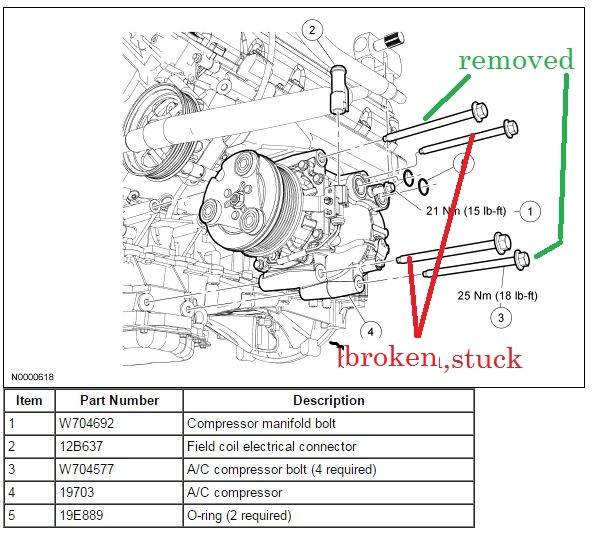

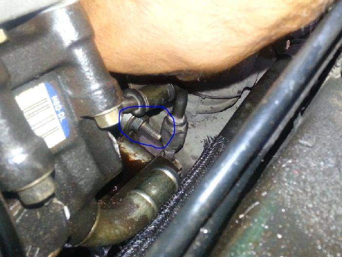

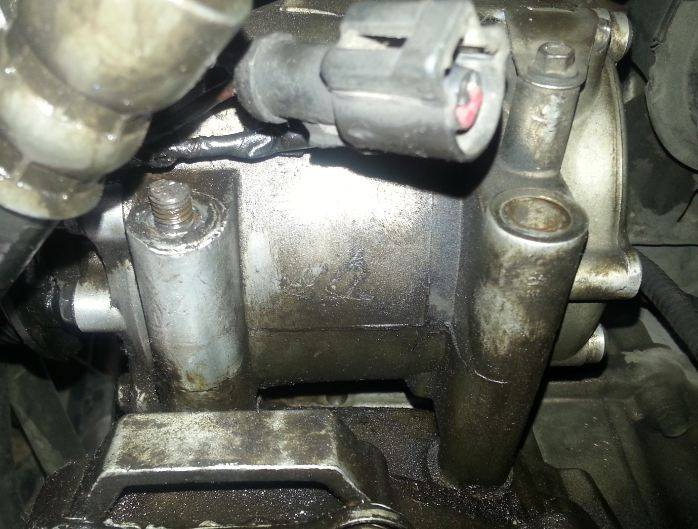

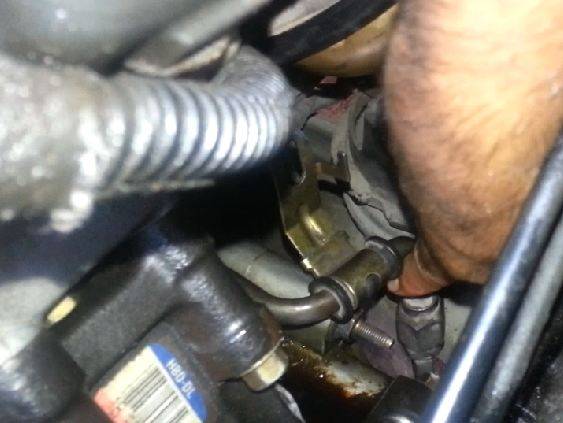

Today,I was trying to remove the power steering pump :Bang
I couldn't remove all Air conditioning compressor bolts,just 2 of them.
1 looks like a broken bolt and it had a nut and was overtighten,the othen one is overtighten bolt and it's not a 10mm bolt >_<.
As you can see there was a bad repair,look how the pressure line bracket it's not bolted .
This one looks good but it's stuck.
The broken bolt had a nut,maybe to cover the $hit done.
Any idea about how to remove them ?suggestions are welcome.
thank you!

Clamp on with good vice-grips, or maybe double nut them and remove via the inner nut? (Looks like there is probably not enough stud sticking out to do that though.)
I wonder how they managed to do that in the first place? Not a good sign for what else you may find...
thank you for reply!
I'll try with the vise-grips.
Yes, it's a pandora box. surprises everywhere, damm just because I really love the car. :p
thank you again,very helpful!
Best regards!
I didn't know the double nut method.
-->a video of how to do it
Hi!
Today we got the bolt removed and the stud had to be broken.
No way to get them out.
Best regards!

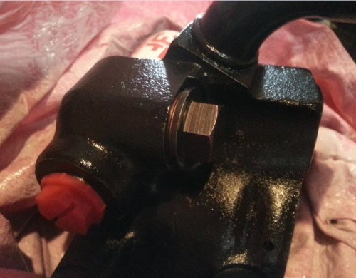

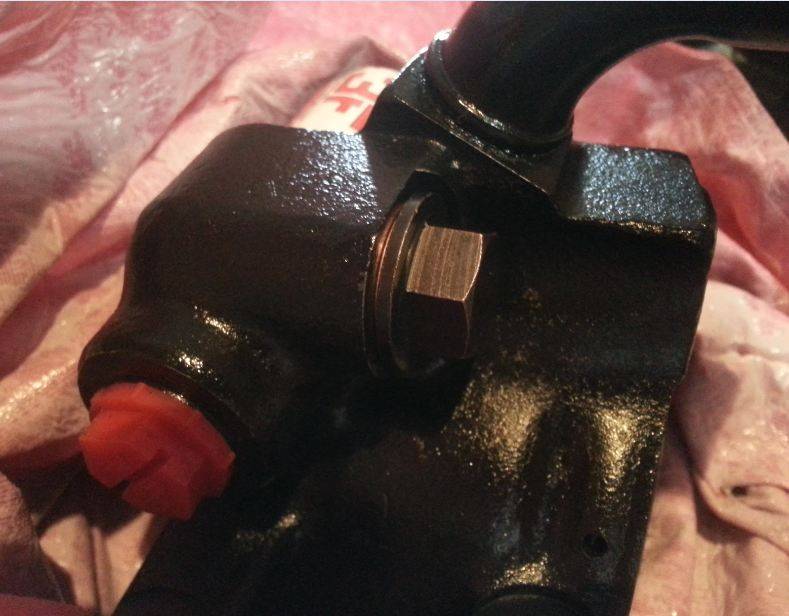

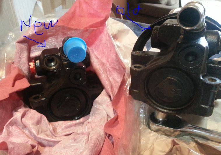

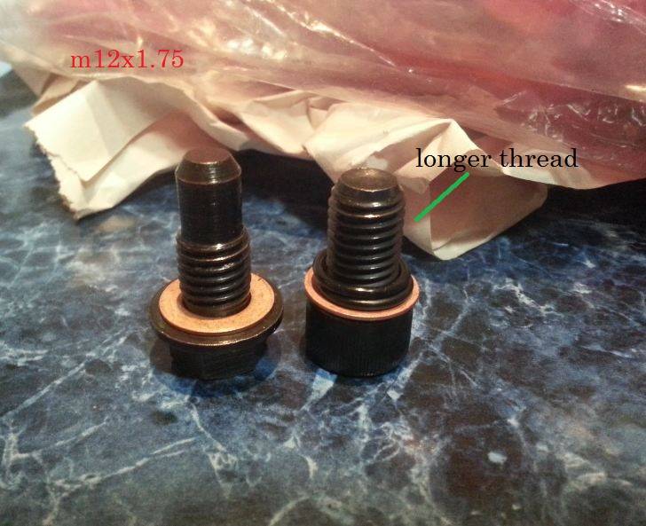

I received the power steering pump :wrench but I ordered the wrong one dammm:shifty: It has the pressure switch port on the back and mine does not come with it. :Bang
I'll use a m12x1.75 cap with a brass washer.
What else could I use to make it fully sealed ?
Best regards!

Finally the power steering pump is installed.
NO oil leaks, the m12x1.75 cap works ok.

Just a word of caution, try to figure out how precisely the pressure switch works to make sure your mod is OK. My **assumption** is the non-switch pump is expected to run full pressure all the time, while the switch pump has an internal bypass that can lower pressure, typically when driving at speed. So you want to make sure the bypass is blocked so you get full pressure all the time. Otherwise you might get minimum (or less, if the pressure switch itself is critical in controlling bypass flow) pressure at all times, which will result in rather tough steering when moving slow (e.g., parking).
IOW, I'd really really recommend getting the correct pump.
If the bypass is running too much fluid, that will be noisy.
I've done more PS work than I care to remember, and noise tends to come down to leaks letting air get into the fluid, or cavitation in the pump (generally due to blockage in feed or output). I worry in this case it may be the cavitation due to the mod, and thus is now a "feature".
For a fully fresh system it can take 100+ miles for all the microbubbles to work out of the fluid. The vacuum process helps speed this along.
IMO, the premature failure warnings are a exaggerated, but YMMV. An active leak in the supply hose, or low level letting the pump suck air into the stream, WILL cause the pump to run dry which does cause wear. But the initial working out the bubbles? Not so much.
Nope. They both work the same way. There is a pressure switch either way as well. When it's not on the pump, it is in the middle of the high pressure hose. Either way, it has nothing to do with bypass (that's all in the rack). The switch tells the PCM that some extra load is being put on the engine, so it can react before engine RPM drops much.
