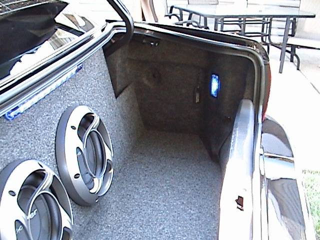

my 2001 has one in the upper passenger side inner fender liner.

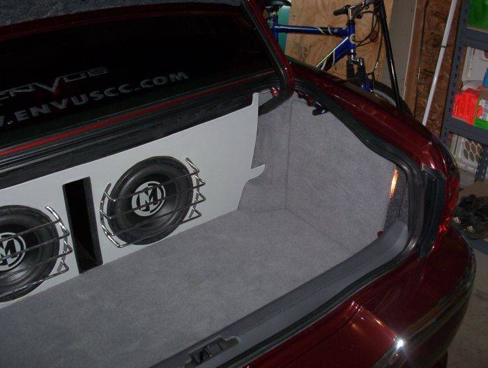

Should be right to the right of this picture. this pic was taken at night and the light that is shining is coming from the trunk. this is where your light should be if you have one.
to the right of what picture decibels? i see no picture
thats weird, I see it. dont understand:confused: :confused: , this happened to another user earlier, what going on?
Far left. Just see the edge of it behind the beauty board.

ok so i posted that thread last night right after i noticed i had no light, so today i pop the trunk and see the light like all of you are showing me. my light is burned out anyone know if there is a specific light number i need? or what i want to replace it
