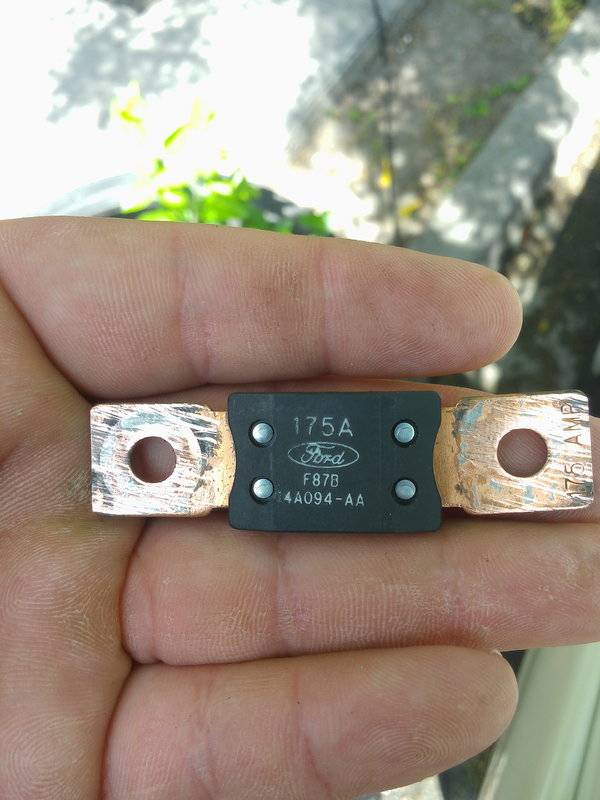

Friend, already solve my problem, it was a fuse or relay that is located behind the box of fuses that is inside the baul

At the end it was a fuse or relay that is on the side of the fuse box that is in the trunk
