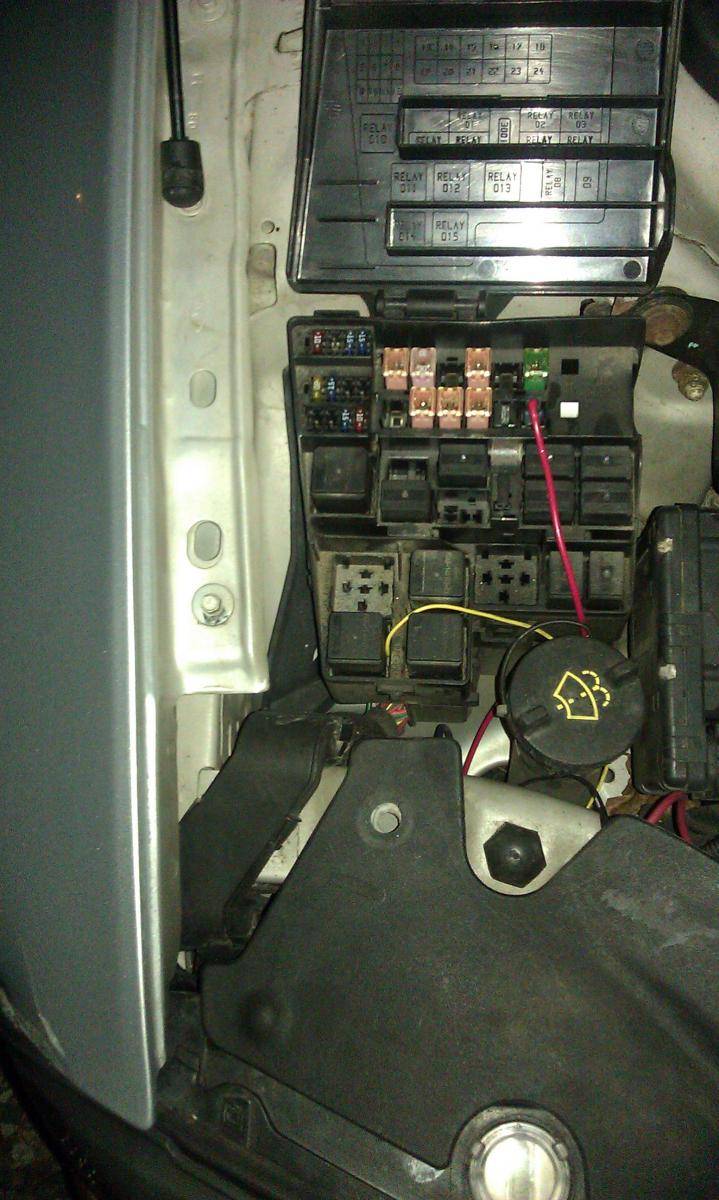

ok, so now im weirded out and dont wanna mess with anything...strange wire coming out of the PCM relay and other spots in the fuse box...no clue if this is normal or wtf the previous owner was doing here...?
probably just gonna wait til the AM and take it somewhere and have it looked at...
That might be your problem.
Those wires should not be there.
And sad that the dealer did not catch this either.
Looks like power is being slaved from there to something which could be jacking with the pcm and giving you hard starts.
is it safe for me to remove the relay with the wire in it move it to the heated wiper slot and vice versa?
That i cant say all i know is there should be no wires under that cover.
well i just went and changed them...5 or 6 tries and couldnt replicate the PATs error...when i went to pull the PATs code 16 earlier it only took one try...guess we'll wait and see...
It makes sense that the add on wire could be causing poor contact. PATS code 16 fits with P1633. P1633 is "Keep Alive Power Voltage Too Low."
I am again disturbed that the dealer couldn't figure this one out as soon as he read the codes and saw the added wires.
