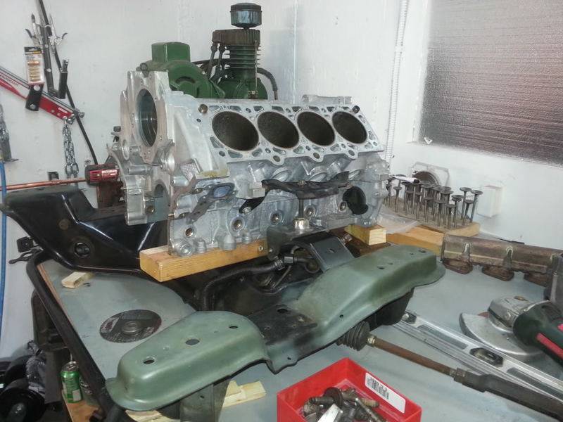

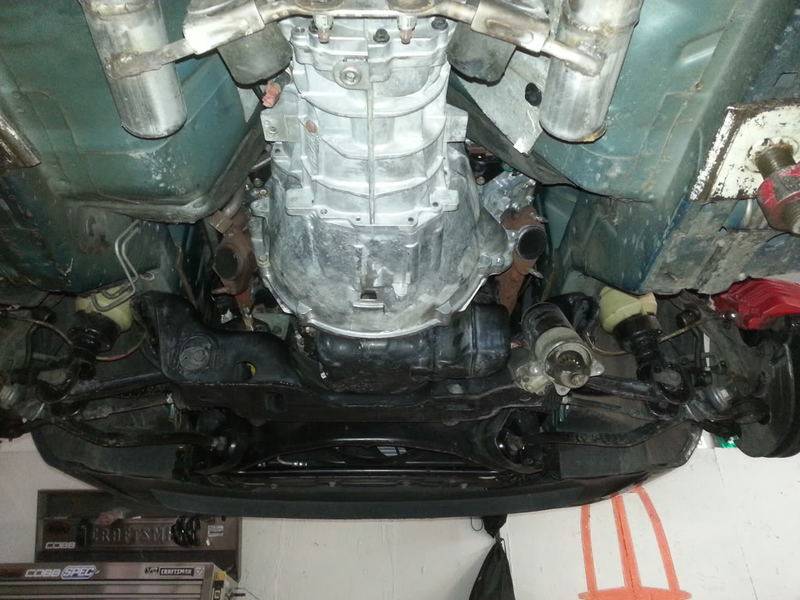

Work, School and my surgery recovery has lightened up on me so I was able to get out in the shop this weekend and get some stuff done. Motor mounts are modified to accept passage of a stainless downpipe. Manifolds are modified as well to begin running the hot side of the 70MM Precision BB turbo. Had to heat and bend the A/C lines coming out of the compressor to clear the new Up-pipe on the passenger side.

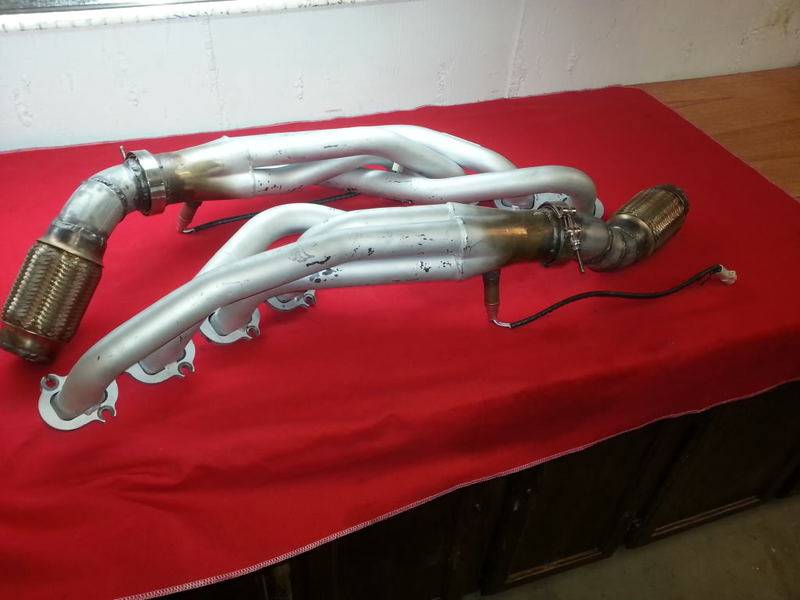

The headers are going to K9t8m for his 96, and I'll be ripping this system out and modifying it to work with the new components.

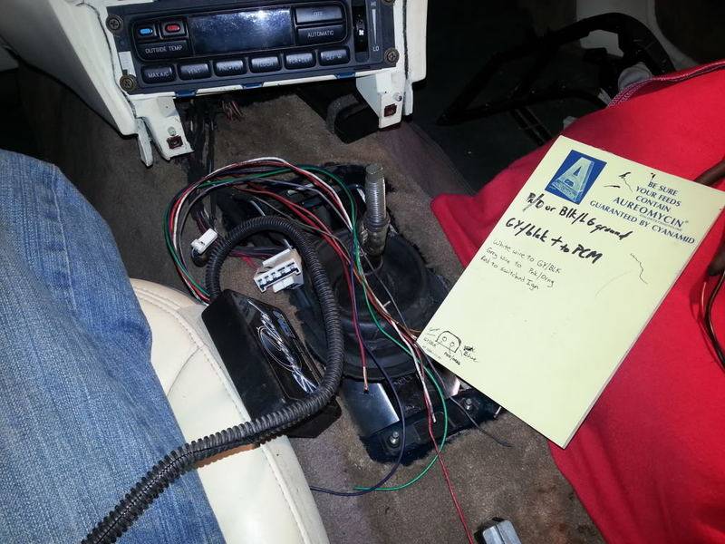

Speed cal is wired in as well, so the air-ride, and VSA works like it should as well.

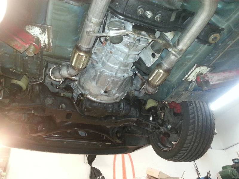

Update.

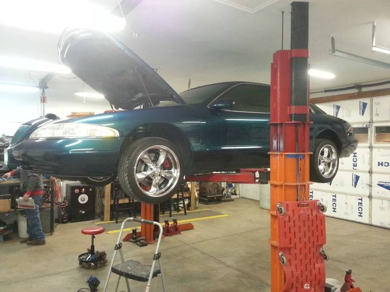

I hated the exhaust setup so badly, that I ripped it apart for a redux.

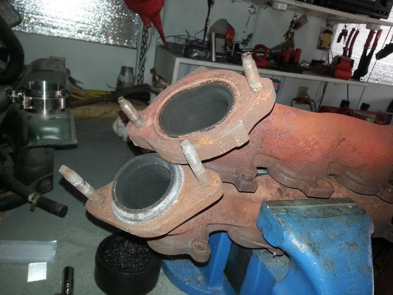

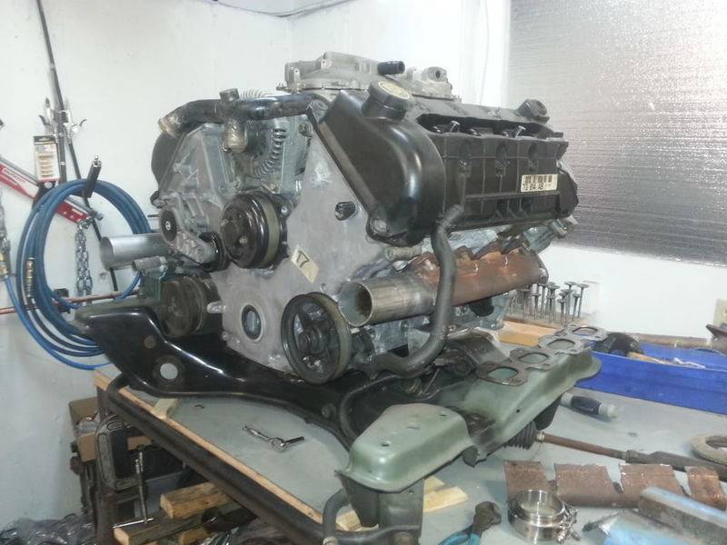

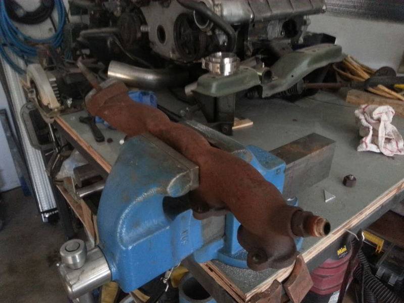

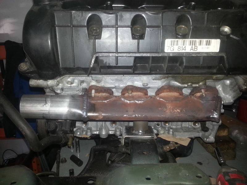

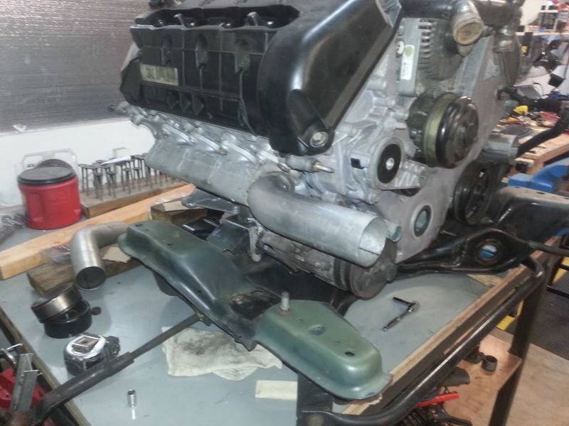

Kooks are gone and given to k9t8m for his 96. I had this set of Terminator manifolds sitting in a parts tote for a while so I figured what the hell and started putting them on. Drivers side is on and bolted down, with little interference from the dipstick. (Steering mods are on their way)

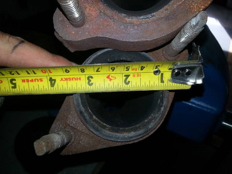

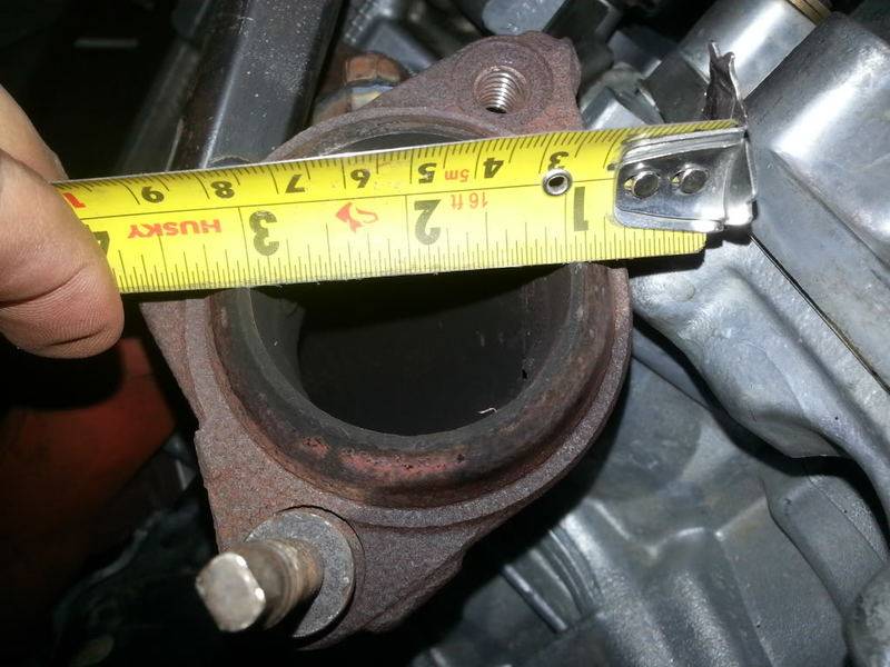

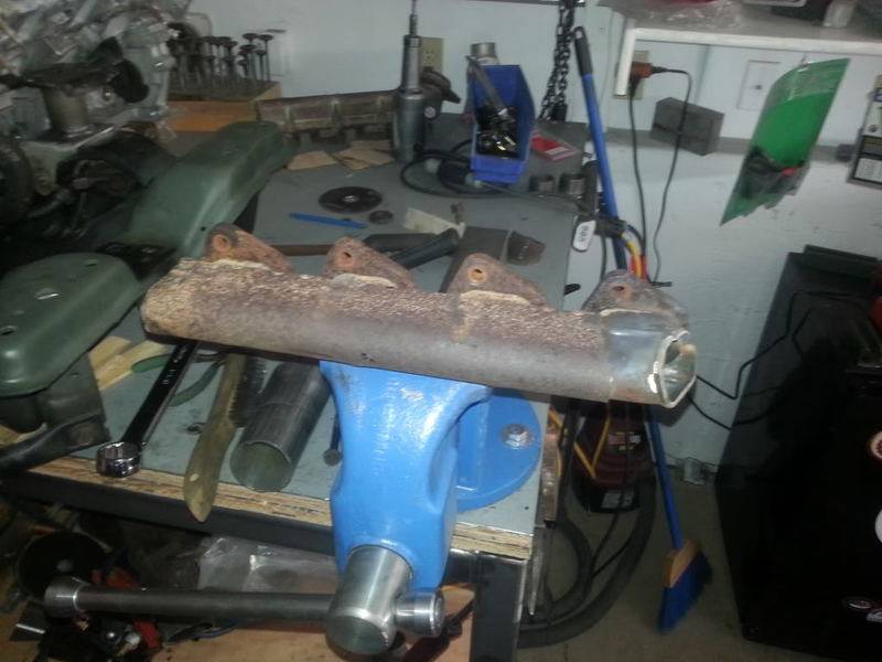

For the Passenger side I decided to get the mape teasure out and check to see what I can run instead of the funky terminator pass side unit. This one I'm using is a stock gen2 manifold. (Same outlet Diameter, just the smaller primary ports which is'nt a problem anyway because this is a stock engine.)

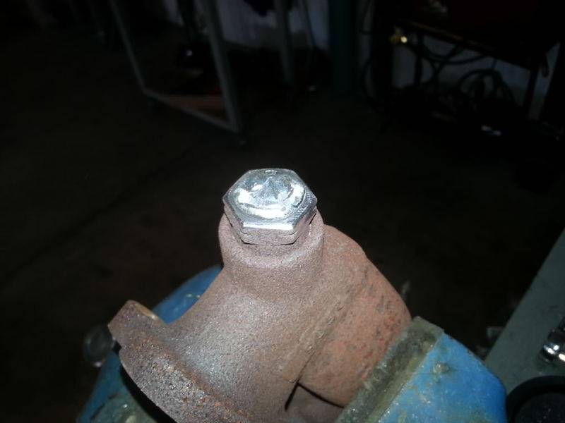

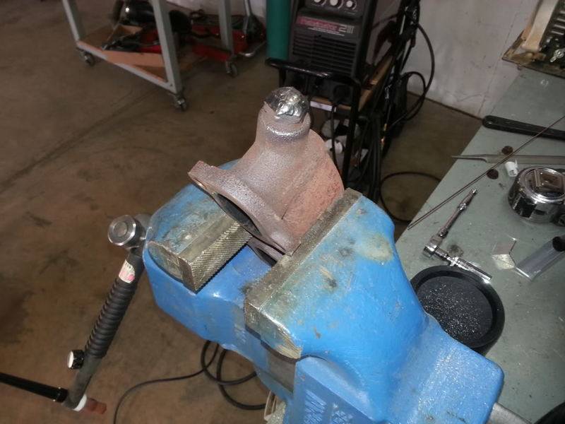

While I had it easily accessable, I figured I would TIG the A.I.R. injection bung closed.
Now I don't have to worry about finding that stupid passenger side downpipe. Easy peasy.
The final (I hope) setup is as follows. Magnaflow Highflow Cats. Modified 2.5"x2 input to modified to 1 oval output magnaflow in the middle. New quiet rear mufflers are on the way as well.
I'm done with loud. :)
