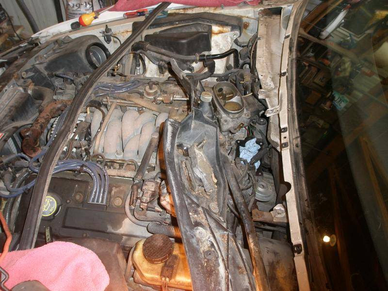

Well I got the IAC, TPS, and gasket all put in today and man was it a bitch. I am taking a break right now, but I also have plugs to do and put it all back together.. Ill post some pics later on tonight

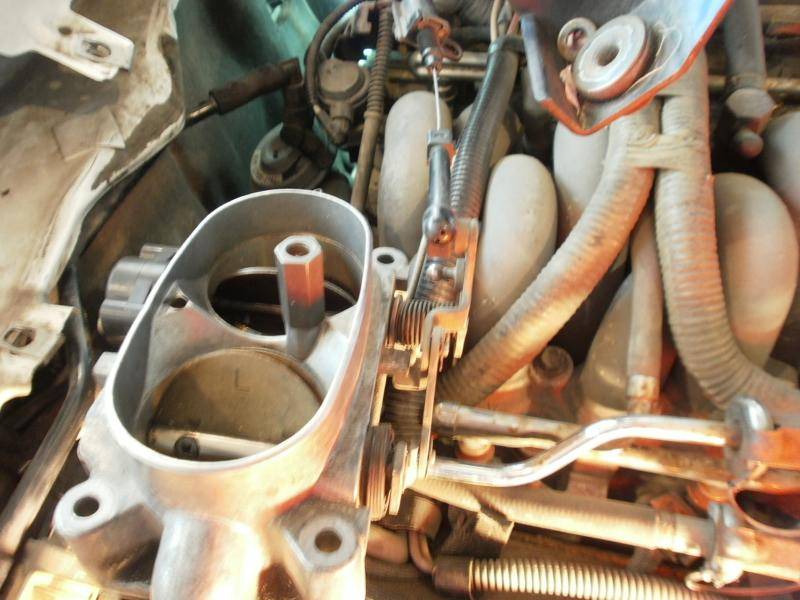

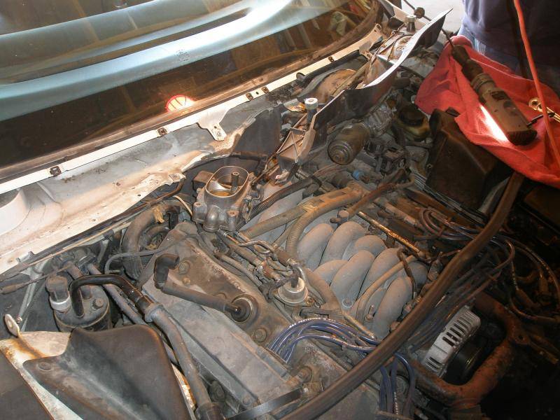

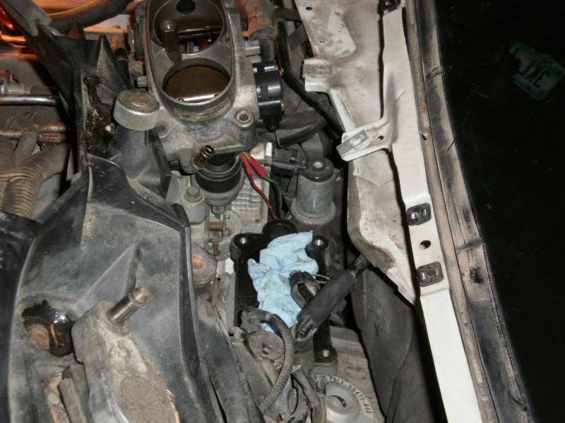

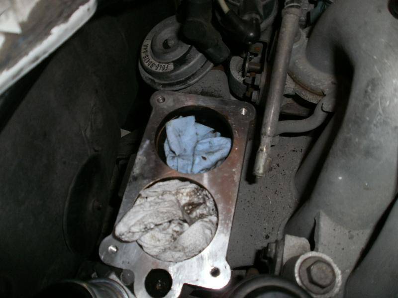

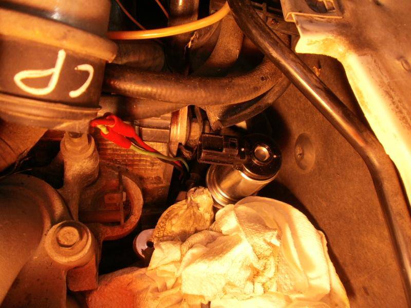

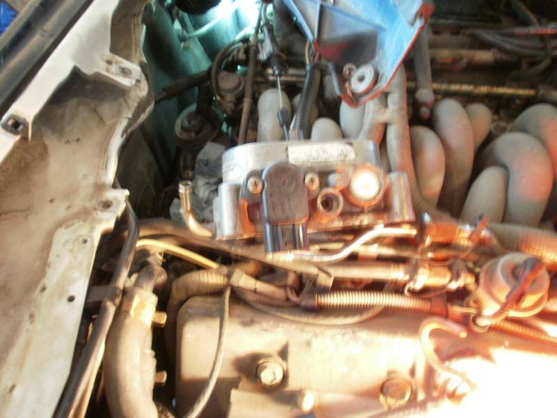

you need to remove the wiper cowling, and then your air intake should be able to come off. Now that you have this off if you look at the back of the engine you will see your throttle body. remove the four bolts that hold this on and disconnect your cables and your TPS sensor (only electrical plug). once you have done this put rags of some sort down there so that nothing can fall in. Now if you look to the left of where your throttle body was you should be able to see the Idle Air Control (IAC). There are 2 bolts. The one against the firewall is a bolt (8mm), and the other is a stud that will unscrew (8mm). I used an 8mm wrench to break the bolts lose and then on the firewall side I used a flexible socket extension (6 inches long) and a sold extension about 6 inches long. You can get at the bolt through the passenger side (ITS A TIGHT FIT). I had someone watch and guide the socket on with a screw driver. The stud one is a little more tricky. I got a piece of tubing the was a tight fit and slid that over the stud part. I was able to use the tube and back the bolt out also through the passenger side when had someone guide me. Now you should have an electrical connector on the top disconnect that and pull the IAC out. You want to get the old gasket off so just lightly use a razor blade and scrape off if needed.
Now you are ready to install the new one. put something sticky (i used formagasket) onto the new gasket to hold it in place on the IAC. once you get the valve in place start the bolts and use those same tools as above to thread in. I recommend replacing that electrical unit on the throttle body (thats the TPS), because its not that much money and your already right there. You need to scrape the old gasket off the throttle body and replace with a new one. Once this is done you can rebolt the throttle body back on and reconnect all the lines. Now you can reconnect everything.
