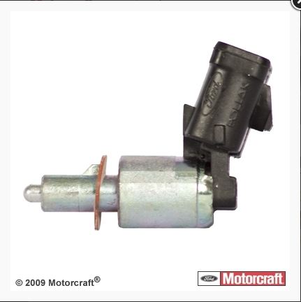

I would just go ahead and replace the one in the door. Here is what the door ajar sensor looks like. It's berried in the door look mechanism in the door. Make sure to have a bucket of cuss words ready before starting. The switch in the door jam is a common fault as well.

I response to the other posts, I cleaned the door switch sensors a few months ago (same as my MN12's as well) and it made things better for a while, but the issues came back... sometimes the door chime sensor will kick on while I am driving down the street if I go over a large enough bump, and its pretty irritating... Ill pick up some new switches and door handles from a continental soon I guess, since my drivers door handle is falling off.
