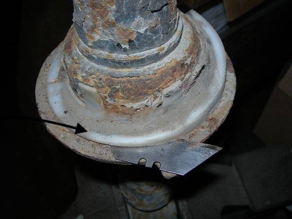

Everything is ordered now! I went ahead and snagged up the rear ones this morning so all that is left is trying to find them new isolators. I am going to go to the Jaguar dealership once I have these in hand and taking your picture to them of the isolator and telling them to find that correct part number for us all to have. $636 total so far in the shocks and springs so not horrible considering. Also once I have the springs and shocks off my LS I will list them for sale here if anyone wants them. My springs were in decent shape from my understanding and I just had replaced the rear shocks with the OEM twin-tube ones so if anyone needs them they have less than 3,000 miles on them. Which is another reason I am trying to find new isolators so I can hopefully help someone out without having to screw up a working set. And the front ones are not completely worn out I am just trying improve the ride a little bit as the front ones are the mono-tube style and the rear are currently the twin-tube.

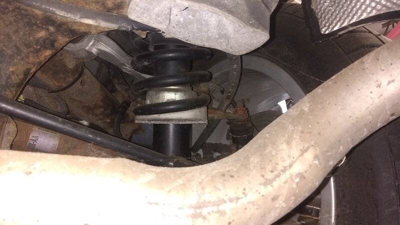

All 4 are gonna look like this and be at the bottom right?
Someone will be getting some nice shock absorbers and springs since you're posted up in the south
Yeah, for sure! I just ordered the moog mount kits for all 4 so trying my best to keep the old ones in working order and still assembled.

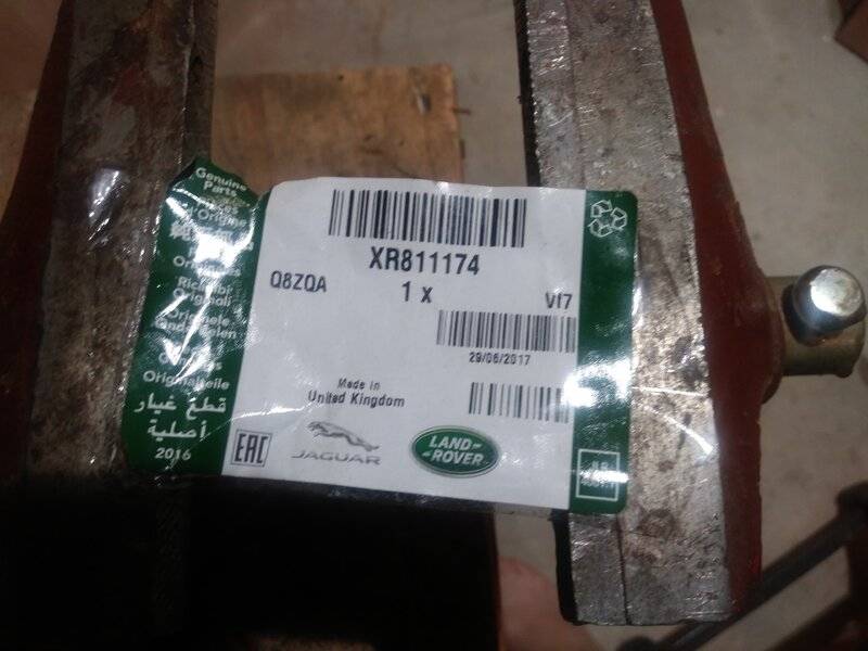

This is the sticker on the springs which i ordered from a jag dealer, i am questioning they are the right size. They are bigger than the spring isolators that I've taken off the rear of my LS (2000 6cyl manual). 04_sport_ls thanks for the help so far.
Other than the XR811174 i dont think the other numbers on the sticker mean anything.
anyone who has a rear isolator out of their LS, even a broken one. Can you do me a favor? Can you measure the inner and outer diameter of it please? The isolator I just took out of the driver rear of my LS (2000 6cyl manual) has these measurements with a caliper: ID 2.8 inches and OD 3.8 inches. (I can measure again to get mm). thanks!
