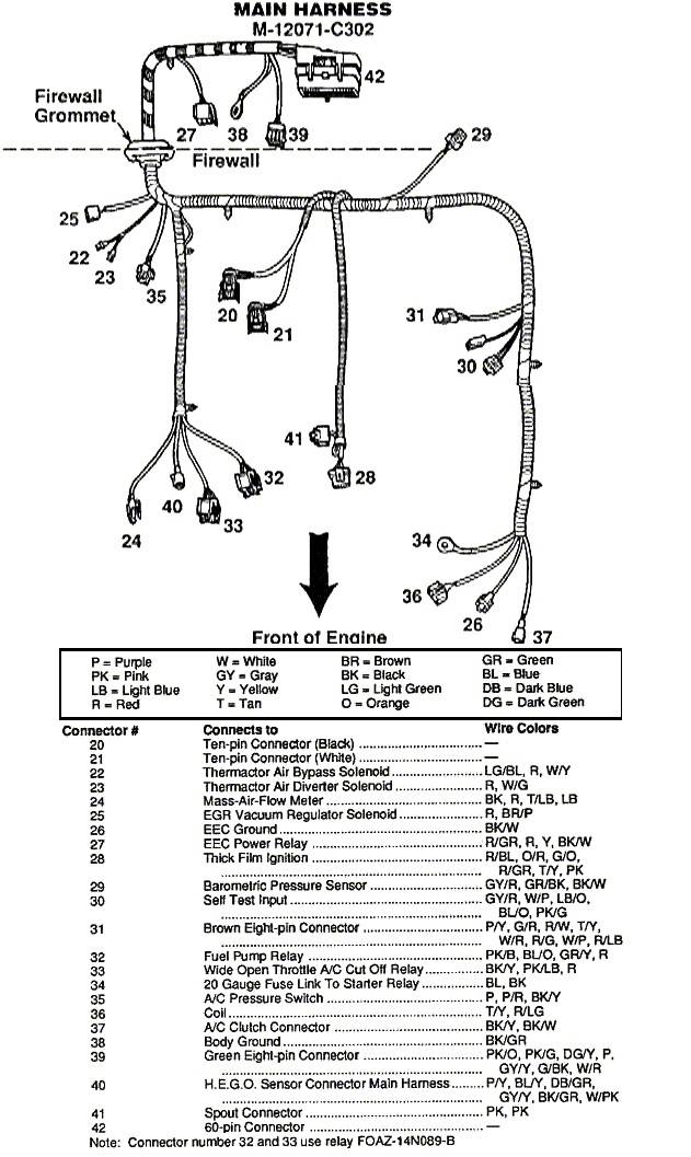

    3. Now you will have to remove the spout connector found hanging from the single wire attached to the distributor wire harness.

    7. You will now want to reconnect the spout connector. If this is not done, the computer will not allow for maximum timing and fuel curve.
