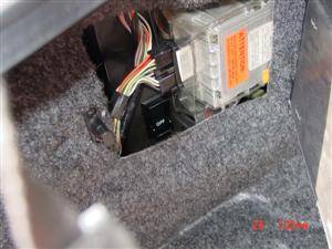

1. Turn off the air ride suspension switch, located in the truck on driver’s side. This is very important and failing to do so could damage your suspension!

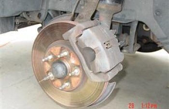

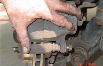

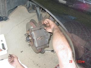

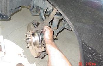

8. Remove the two bolts on the rear of the caliper assembly, and remove the caliper assembly.
9. Remove the old pads. Raise the hood and open the cap on the brake fluid reservior so as to relieve the fluid pressure. Now place your caliper compression tool into the caliper using one of the old brake pads as a brace and compress the caliper. This is done to make room for the new, thicker pads. I like to now tie the caliper assembly to a part of the suspension to keep pressure off of the brake lines.

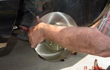

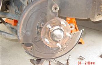

11. Now replace the caliper cradle and replace the bolts that secure it. (this is only necessary in the 1993 – 1996 models, 1997 – 1998 models have a one piece assembly)

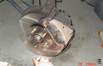

12. Place your new brake pads in place in the cradle and then replace the caliper over them securing the caliper in the proper position. (this is only necessary in the 1993 – 1996 models, 1997 – 1998 models have a one piece assembly and you have to place the pads in the caliper as you slide the caliper down onto the rotor) Remove the rope you used to tie the caliper up.
13. Replace the original 2 bolts on the rear of the caliper. Spray the entire assembly with brake cleaner wiping any excess cleaner away.

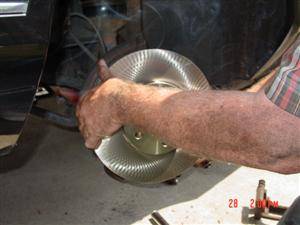

Replacing the front brake pads and rotors on a first generation Lincoln Mark VIII is so easy, it should be criminal allowing a dealer to do it for you. This is something that anyone can do. It takes about an hour to do both front brakes.
This “How To” explains how to change both pads and rotors. You don’t have to change the rotors, but with low cost rotors such as these, I always figure I might as well change them and have new rotors. This is personal preference on my part. You can have the rotors turned at a brake shop and replace the original ones if you prefer.

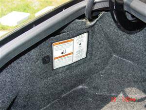

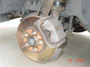

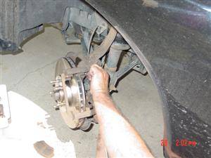

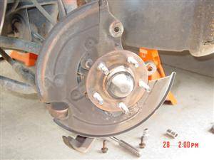

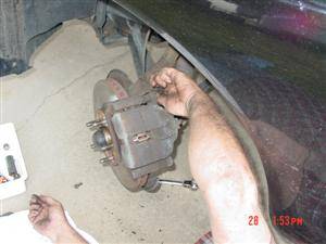

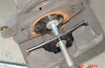

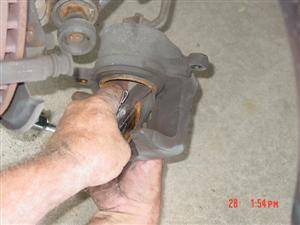

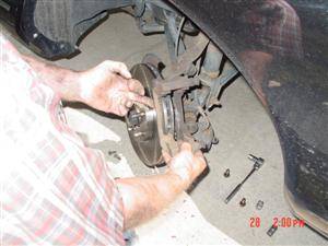

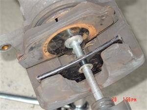

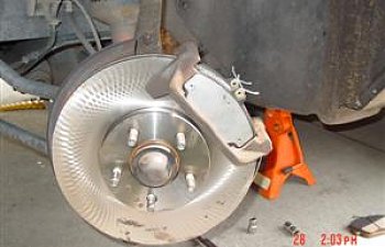

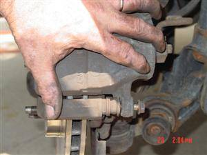

7. Now, inspect the brake system. Look for leaks, cracking lines, or anything that looks like its going to fail soon. I had no such problems.
