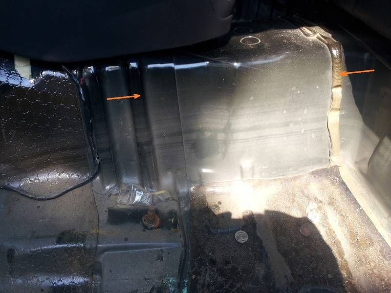

1. Mike and I removed the seats and we now get a good idea of how high the water got.

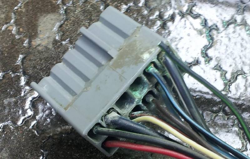

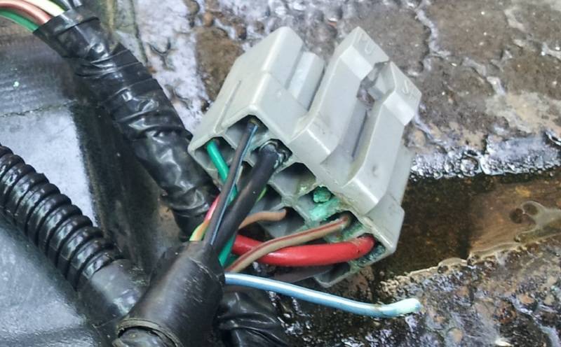

2. Driver's side connector. This was like new when it was replaced after the last flood in 2011. Can this thing really have corroded and broken in a span of around five hours under water or do I have some other problems to investigate? It seems impossible for it to go from corrosion-free to this in such a short time.
3. Ditto passenger side. Oh yeah, the seat did exactly what it did last time... slid back and reclined all the way back on its own.
By the way, the seat tracks are definitely fried. Green fuzz on everything and fresh rust coming out of the motors. I've got a handle on a pair of tracks from a local guy for a fair price.

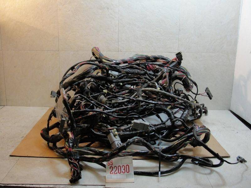

I'm REALLY tempted to try and install a complete harness rather than splice in another set of connectors. The car will be in a friend's garage for as long as needed, so time is not an issue. Just how far does this monster harness reach into the dash and into the back? If I have to pull the dash out of the car, so be it.
I mean how hard can this be?
And that's a 95. Yeah I guess I'll back off of that plan. LOL

Just so we're clear, by "harness" we're talking about the hundred pounds of wiring that I posted a pic of above.
I'm not totally opposed to replacing the entire harness but after a through examination of what I could get to, the only things that were visibly damaged were the seat plugs. I checked the plugs that are behind the kick panels, and the water never got up that high. The plugs are mint. Same with the doors.
I saw no joints in the harness where it had been submerged. So as long as I properly solder new pigtails onto the existing harness, use marine-grade shrink wrap (this), and glop a bunch of dielectric grease on the plugs (something I didn't do last time), what can go wrong? That's not a rhetorical question. I'm asking seriously because I don't know.
If you inspected and all looks fine you should be good
And yes you need to use some dielectric grease.
