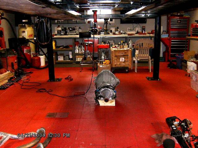

How much are you planning to pay to get the swap done? I'm sure I'd be willing to do it for a bit less, and you'd get to help. ;)
I LOVE your setup DLF. Man I wish I had that cause the work I do would be SOOOOOOOOO much easier. I could also maybe get my car half as clean as yours under neath it. :lol:
