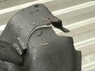

So I've been complaining about the extreme violent vibrations above 65mph and suspension was one thought, the other was driveshaft yoke. Well....
I had a shop look at it and they said the suspension is fine, but the ball joints will need to be replaced sometime in the next few months because they are showing signs of wear.
After not finding anything the guy gets in the car, has the other guy stand in front of the engine, puts it in D, then mashes the brake and gives it gas. Man that engine practically leaped out of the car. That thing is definitely needing to be replaced!
So I looked on supercoupe performance and they don't have polyurethane mounts for the engine. Where can I get a pair and is that the right route on a DD? Keep in mind I'm pretty rough on this car....

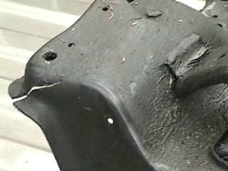

be prepared... you might find that the saddles the mounts sit on are broken too.
Mine were

:eek: That wouldn't be fun
yea it sucked had to change the hole K member, but it was broken in another place anyways.. so it wasn't JUST the motormount saddles that caused the replacement.
I've got some pics "somewhere".. I'll dig em up.
Man that is harsh! Was that from using it while the motor mount was broke so it started to torque the saddles? That is insane!
