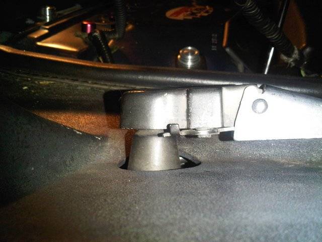

Note the pic below, the arm is down and you can see a small tab which is the lever to lock the arm up off the glass.
To remove the wiper arm, you lift the arm off the glass and pull out on the locking tab and release the arm. The locking tab will then be holding the arm tension with the wiper off the glass.
Then it is a simple matter of pulling the wiper arm off the pivot.

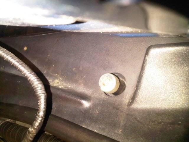

There is a small woodruff key that aligns the wiper arms in the proper position. It is so small, you likely never noticed it and it is lost. You can still get them in the proper position, it just takes some time to fiddle with it.
youre probably right. but it apears like there is a notch on the part where the arm goes. so i just slide it into the notch and say f-it.
