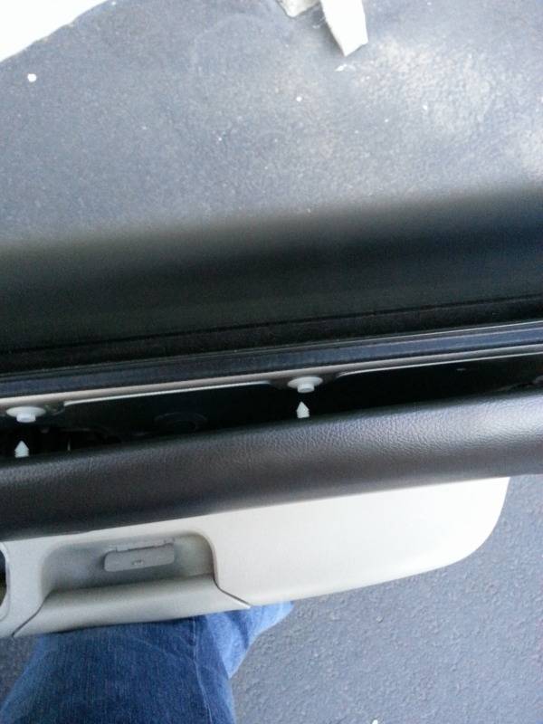

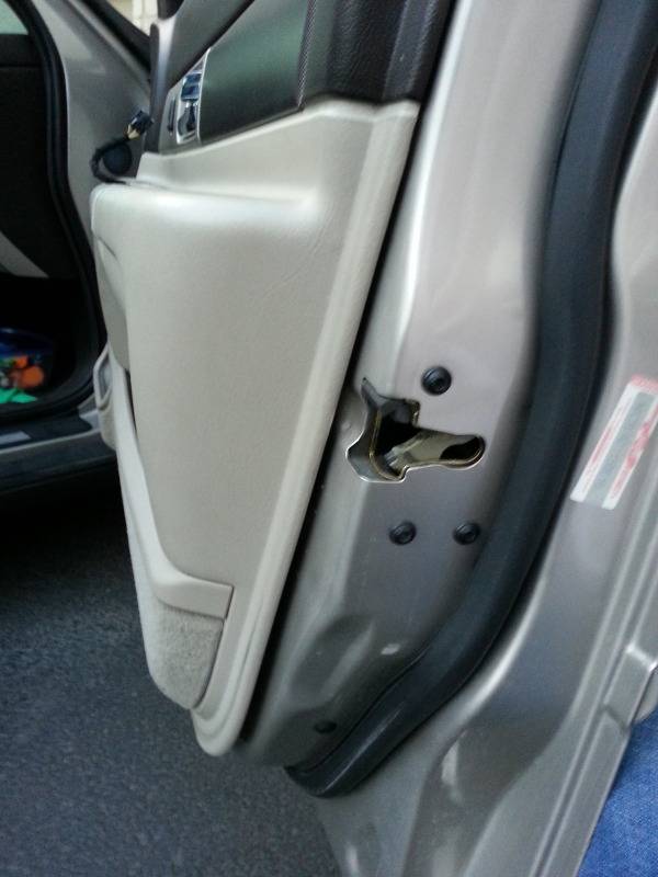

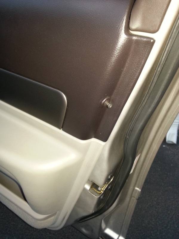

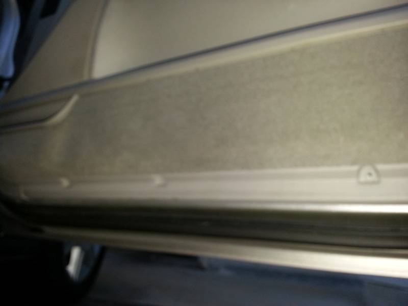

Here you go BigRig:

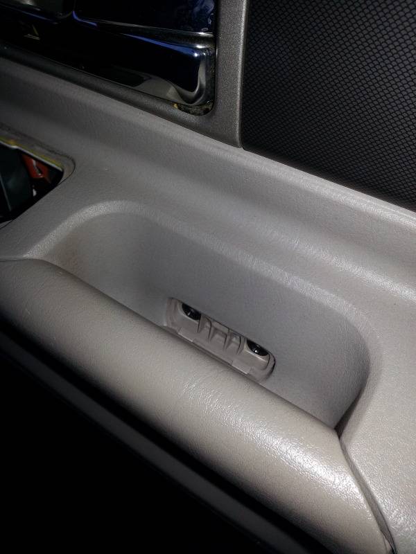

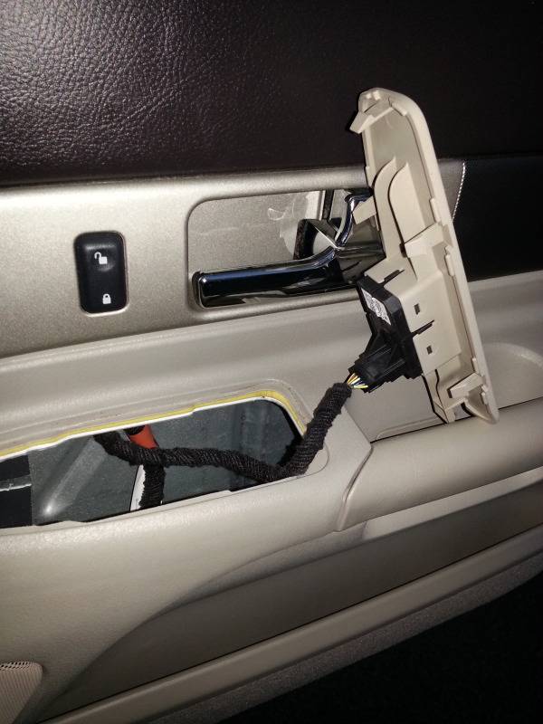

pop the window switch off and disconnect the plug on the underside
two screws under a flap behind the door grab
one screw along the trailing edge
three screws along the bottom edge
start finding pins (9 of them in total), use a panel puller or mini-pry-bar and try to find the most resistance to pull/twist against (PULL them, don't be a wussy).
then unplug any connectors and voila

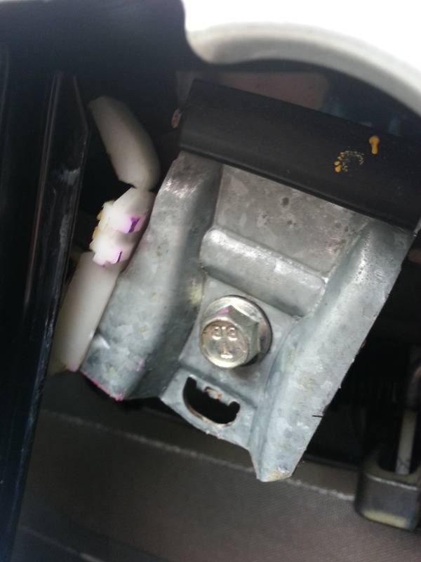

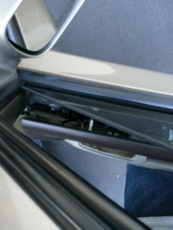

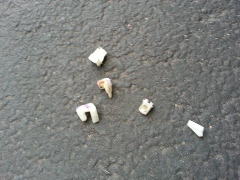

I couldn't see the motor, I didn't pull the plate off, but here is the problem:
clip on front rail. the rear rail wasn't in any better condition
pieces of clips removed from the inside of the door
Like I said I couldn't see the motor. But if the clips are unique, I'd have to say the pieces look like the pics of the Gen II smart motor.
I'd be pretty sure you have the gen II smart motor setup since you have auto-up and bounce back. AFAIK, the motor very rarely fails, so no need to order more than just the regulator.

if the motor works fine, and you recovered a bunch of broke plastic, i would not waste any money on a motor, with two LS's and three broke regulators, i have not had to replace a motor yet!

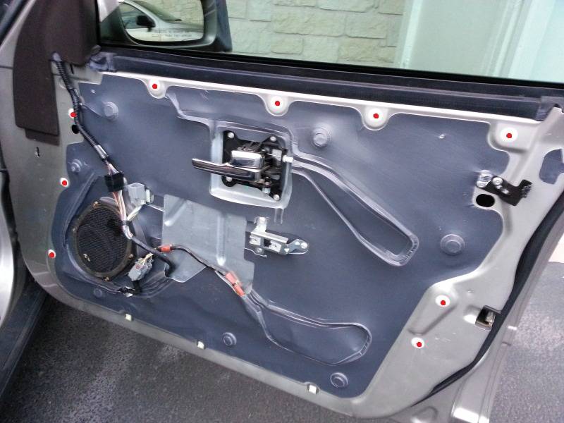

Thanks Stumpie, I saved this pic to my drive, this is what I wanted to see before I ever have to get into it.
I so hate pulling on any door panels like that without fully knowing where all the pins are.

Don't let the sound of the pins releasing scare you!! It sounds like something is being torn apart!
oh I know it, just my luck, I have managed to break some in the past on other cars.

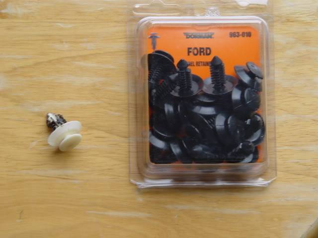

I have a Tool & Fastener store near by me and they have bins full of all sorts of clips.
All sorts of oddball stuff one might need. Very handy place for sourcing cheaper aftermarket or for when you just need one or two of whatever, as apposed to being forced to buy 20 in a box. Last I walked out that store I ended up with a handful of clips for just over 3 dollars.

replace the clips
you can buy replacement clips on ebay.
or you can plastic weld the old clips back together better than new.
this new plastic is repairable with a soldering iron, just line up the broken pieces and heat the plastic back together. I always add some additional plastic to strengthen the area better than new. works great. you can see how its done by searching youtube under plastic welding.

clips
you kinda bend the clip around the metal frame, you'll see. Just take out wire ends and insert them in new clip then slowly bend the clip around the metal frame., yes you need to remove the glass. be careful, just loosen the nuts that hold the glass. lift glass GENTLY out top of door. Gentle with the glass, I had one bind on me and break.
