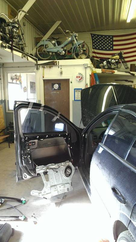

Thanks. time to pop the door panels. Should be educational.
pretty easy to replace... you should run into too many problems
Hey can you do some of us a favor and take some pics of these door panels coming off ?
I'm notorious for breaking plastic fasteners and/or clips.
I just did both my wifes' Olds Alero door handles this weekend after picking up fresh ones from a U-Pull-It yard, ($6.99 each)
and well, let's put it this way, she missing a few clips now!
trade-off, at least the door handles work and aren't laying inside the skin.
who would have thought that behind that little reflector lens on the door, they put a Fn screw?!?! (it broke on one side)
The clips on the LS can take a beating.
I've had that thing off at least a dozen times.

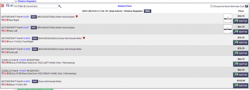

Rock auto says that a window regulator "before 07/03" is $150, whereas the "from 07/03" regulator costs $75. My vin sticker says Date 12/02. Does that mean I'm stuck for the pat thats twice as much? Wtf could the difference be?
One has the motor, the other is just the regulator. Oem sells the same way
Sorry, by "not too expensive" I was thinking of the gen II regulator without the motor.

its a 2003 (Gen 2) but the Date on the sticker in the door jamb says 12/02. Must have been one of the first off the lines
Okay, so you have a 2003. You should have gen II window regulators, but with the 03 model, that may not be certain. It would be best if you took a look at your existing regulator before ordering a new one. Does it have a smart motor (gen II) or not on it?
I'm betting this was some manufacturing eff up on behalf of Ford/Lincoln that we the unfortunate consumer now pay for in the way of increased price for limited stock of parts that were only used on the line for 8 months.
The LS was only made for six years, it shares very few parts with any other cars, and they didn't sell very many of them. We're all screwed on parts.
