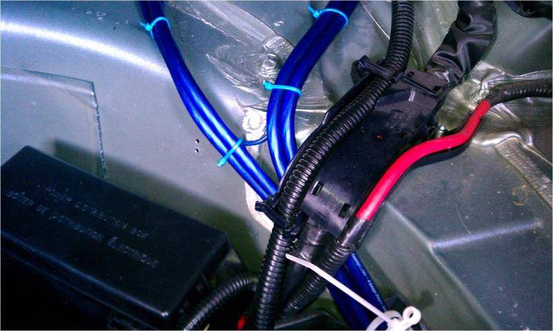

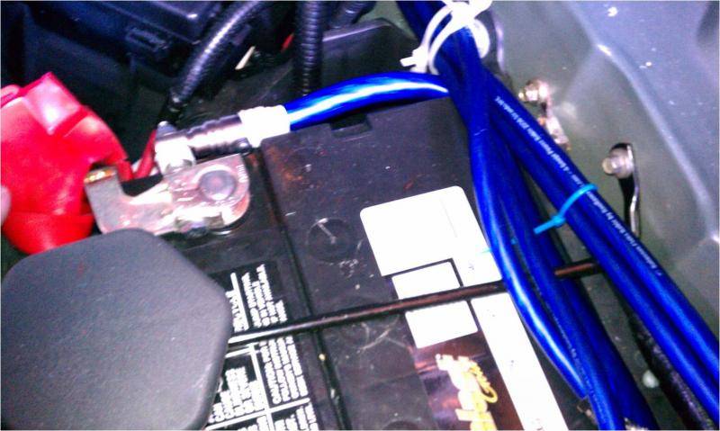

So I pretty much finished the install but my other amp didn't show up so I couldn't hook that up or hook the deck speakers up. Here are some pics. This being my first car audio install ever, I think I did pretty well. I plan to post up some more pics on how I connected the grounds/power to the battery since KnuKonceptz set screws are very thick. To me, it's a pretty damn clean install and I'm pretty proud of myself - especially figuring out the problems along the way and figuring out a pretty decent way to connect the power/ground to the battery.

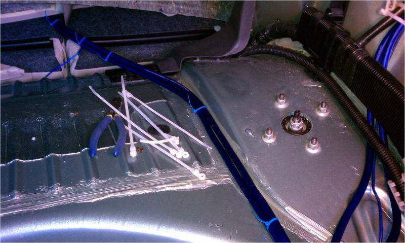

The other amp should be here Monday. I've run the power, ground, remote, and speaker wire and I plan to mount the amp the bottom of the deck. I used a channel on the bottom of the deck to run the wires so they are completely hidden.

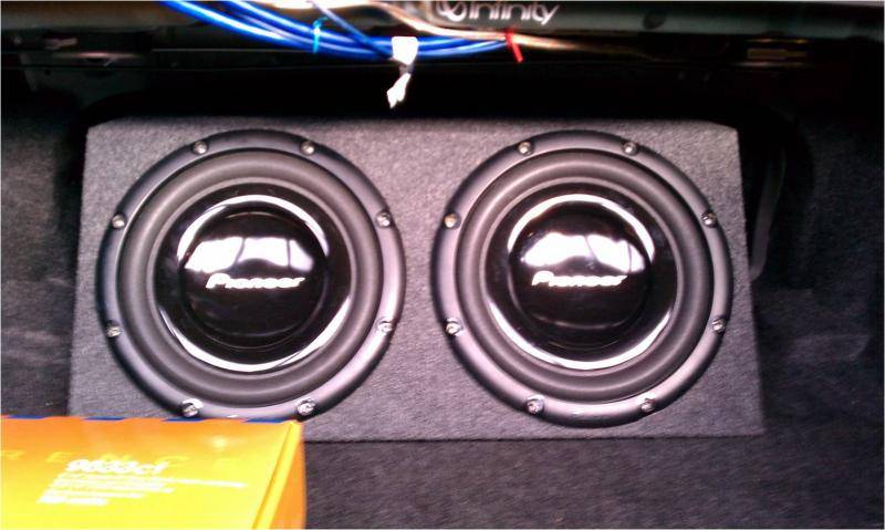

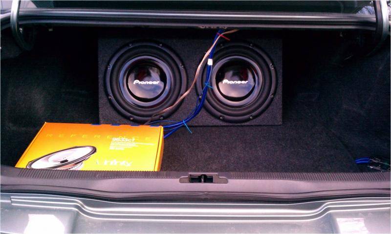

I bought a cheap ($50 shipped to my door) sealed sub box which was the smallest amount of cubic feet allowed for my subs. The box isn't great and I know those Pioneer subs aren't top of the line, but I put some Polyester fiber fill in the box and it sounds better than the $150 ported box I had before - which also didn't slide in under the rear deck. The subs seem to hit harder and tighter which is expected due to the sealed enclosure but I really expected the subs to sound crappy because of the box - luckily I was wrong and they sound awesome. I also bought such a small box so I can access the spare tire and mount the amp/speakers on the rear deck.

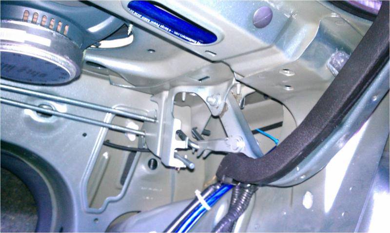

Btw, the amp is mounted to the back of the rear seat. I also clipped the excess of the zip ties so it doesn't look like crap.

your factory wiring was never designed for amps with hundreds (if not thousands) of watts.
the big 3 is upgrading some of the factory wiring in the car to better support the power requirements of the sound system
Routing wires around sharp edges of metal not good! Chaffeeing can cause shorts! IMHO
msgtusmc...if you're referring to my setup, I'm using rubber seal from Mcmaster-Carr around all sharp edges
