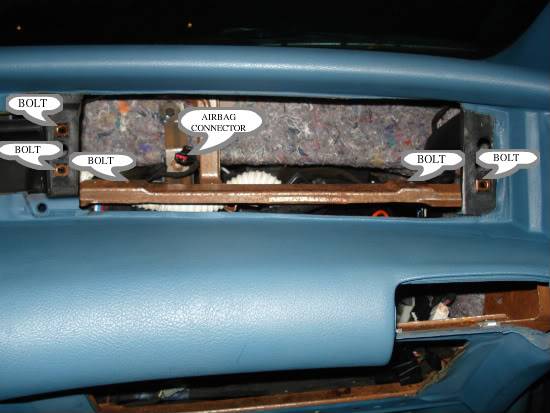

I had some 'fun' a few days ago getting the passenger SRS airbag out.
Superglue and i have become... good friends! :p
How do you get that bag out properly... I tried on both the first gens and they wouldn't come out!
2 bolts secure the bag from underneath, 3 at the sides (only accessible once the big and small black fascia trims are removed - the big one is the pita) Bag has one 2 pin connector.
I never noticed the bolts from underneath... no big deal, I just wanted to pull them out to blow them up....
