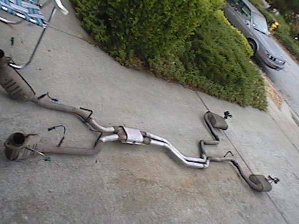

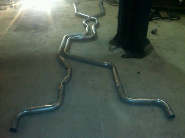

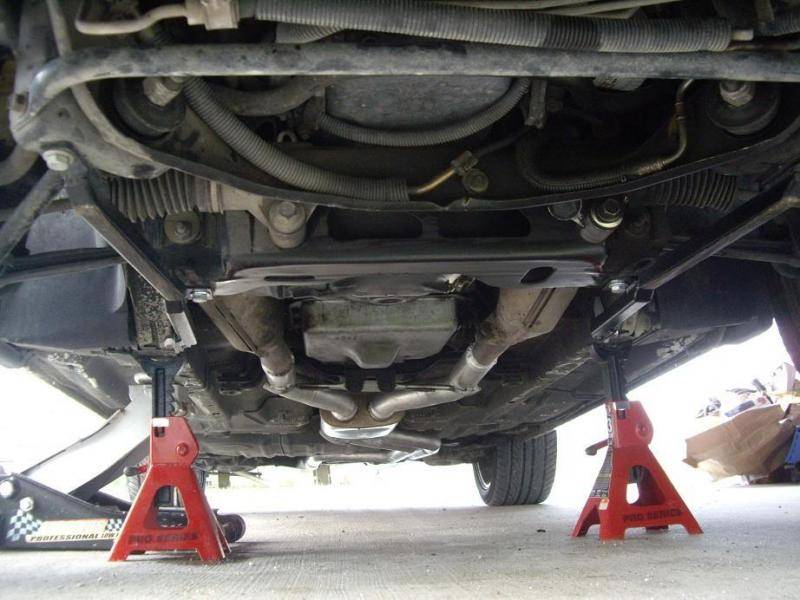

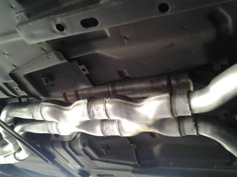

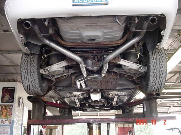

I find it hard to believe that an 18 year old kid would find a $700+ exhaust system budget friendly..and that's not even including the installation. Dude if I were you I would take your car to a couple exhaust shops have them put it up on a lift and show them some pictures of guys dual exhaust set ups from this site..god knows theres plenty of pictures around here. At most buy whatever mufflers you want to use and buy a universal x pipe. You don't need stainless and you don't need mandrel bent stuff if you're just looking for a basic dual exhaust. They can easily bend an exhaust out of 2 1/2" aluminized pipe..been done many times before..ask dnsherrel, his is not a kit. I mean if you have the money then go for it, buy the mandrel systems kit..that's what I will do eventually but in the end I like a clean looking exhaust with no crush bends and I want stainless...BUT like I said it is not necessary and you won't be able to tell a damn bit of difference by sound
2011-10-24130602.jpg38821464021_large.jpgCustomExhaust.jpgFGGDXCA7LKNDNCA8EWY4KCAUCSPL8CAMMFE4HCAVT4QP1CA6LABTPCAN3CGI9CA3911L4CAHWLE55CAIHA0S5CAVIDUQSCA3.jpgm10.jpgmarkVIII030.jpg

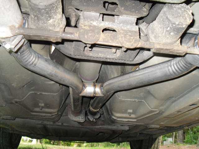

And this is mine.
I agree with Kevin. That stuff gets very pricey by the time you get all of it. Just getting the X added where the 3rd cat is now will free up a lot of air and some nice mufflers will make it sound good. Much much cheaper too. Let the shop do the work.
