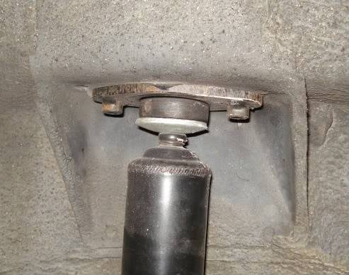

I got solid mounts after I got fed up with the modified original mounts not fitting correctly. Shouldn't affect ride much, as the shock has the rubber isolators and isn't in contact with the mount at all.
93' Blue on blue,i will first admit that i must be an idiot because for the life of me i cant understand how the solids work.I thought the point of the solid mounts was to eliminate the bushing but then wouldnt you have metal to metal contact at the top where it tightens down?Then i read on that "other"site that bushings are still used with the solid mounts but the hole in the solid is very small and i cant see a bushing fitting in there.I cant find a pic of what the solid mount looks like in the trunk with everything hooked up.I am very confused on this.Maybe i am overthinking this.
I have a pic posted up there ^^^^
Obviously, you can't see it while at work - look again when you get home.
But yeah, my solid mounts have smaller holes and the bushings that came with my Sensatracs were a perfect fit into them.
I didnt even see that red X up there...LOL!The bushings that came with my gabriels were huge.Maybe i should go get the sensatracs afterall.I know doing the rear shocks for most is as easy as tying their shoes but this is the first time i have tried this and i appreciate the patience yall have shown me.;)
