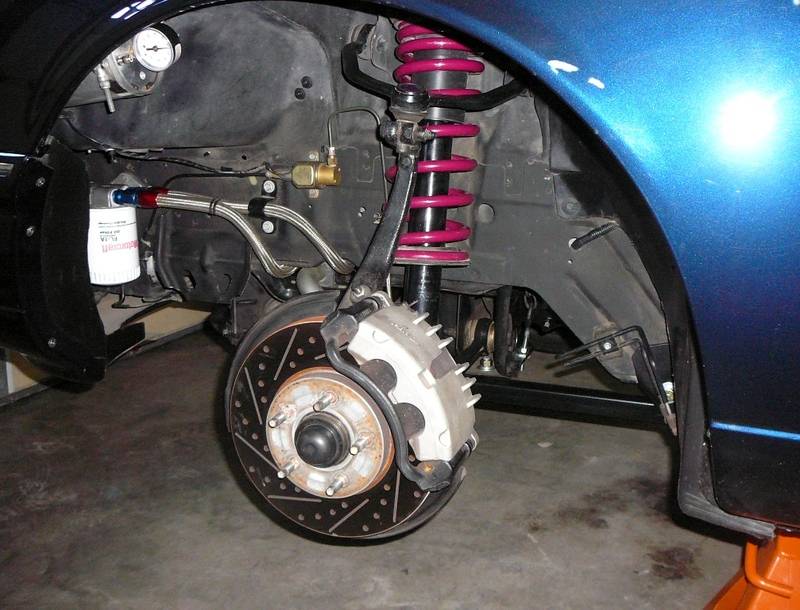

Cheap way to end rap is install an Accusump.
Agreed.
