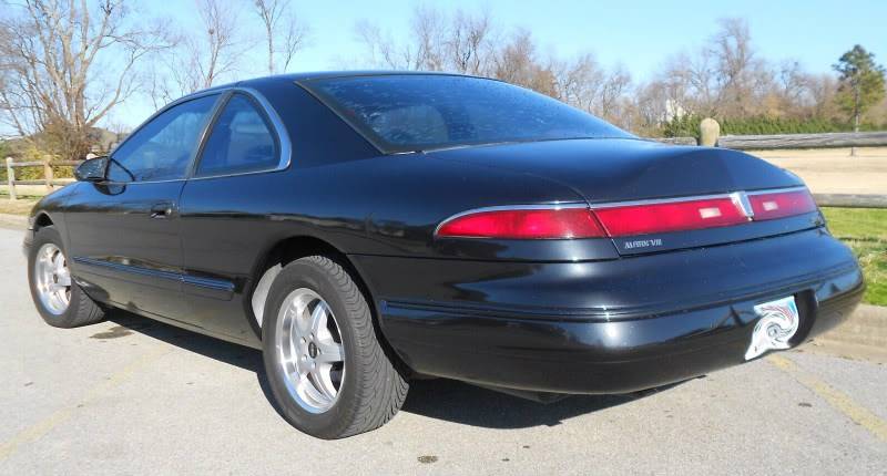

I did a lot of searching and found these. The last says I can go to a 245/45/18 on all four corners. I would think the 255/45/18's would work, but the rims came with 225/40/18 and that looks close to the rear quarter. I have the Asham8 and do like her low.

is anyone running a 255/45/18 on a 18x8 with +40 offset, on all four corners? I would like to be able to rotate the tires.
