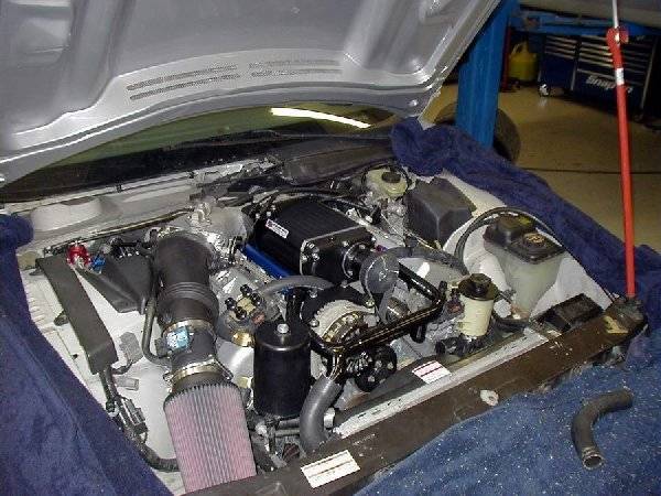

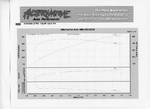

Well, spent last two days with Lidio on tuning & drivability, and alot of progress was made, we put about 60 miles on the combo before it hit the rollers. We managed to go thru a number of changes to the computor and ended up with some decent numbers with a very safe tune on 93 Octane gas. I have to tell you that this car is a blast to drive, as it is a real sleeper and it has all the nice qualities we like in the Marks. With the 3" exhaust it idles quitely a nd very polite, however when you lean on it the sound is very masculine and the KB wHine lets you know something is happening. As soon as I learn how to work with DVD's I will post the last Dyno pull we did, in the mean time here are a couple of pics.
Fcukin Beautiful pics. Is it safe running those wires across the SC? Just wondering, I know there prolly is not enough heat to cause any trouble. i think it says your pushing over 500 horse or torque ? Awesome stuff. I sure hope to see that in person this summer and get a ride ! Congrats.
Thanks. 515HP 468 TQ 13.6 Lbs Boost. The wires are just fine where they are. We tried all kinds of ways to re-route them, but this was the best choice. Other options would have been to convert the whole system to coil on plug, and that wasn't in the cards at this time.

That is VERY beautiful work, and you should get some recognition for the craftsmanship. I have A Twin turbo setup I am pieceing together for my 95', and when done i'm gonna be running up to detroit to have Lido do the tuning work.

They will not. These are a new item that just came out and are for the Gen 1 engines (Coil Pacs). There is another stlye cover for the Gen 2 (Coil On) that isn't Painted. Note for those that want to get these and the oil fill cap cover: You may have to grind clearance into the spark plug cover to allow the cap to rotate freely as was done on mine (about .030").
