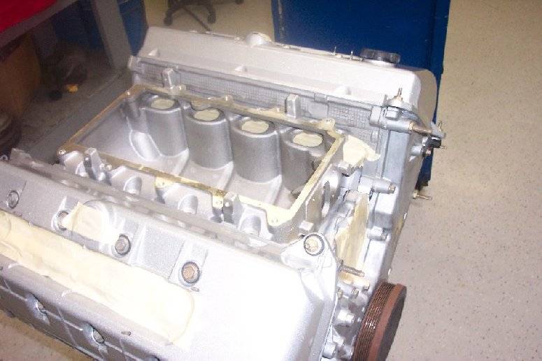

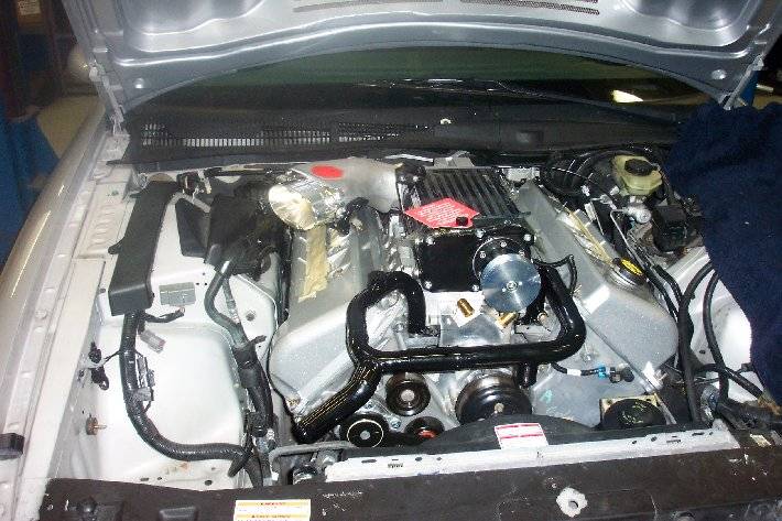

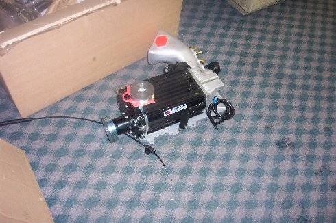

Brad if you get the Kooks coated they will really wow you as they look like pieces of art work, they are bueatiful looking. I got the ones with 3" collectors, and have 3" all the way out.
Santa & The Elves are busy, can't wait for them to finish :D

can you explain about the motor as to whats done to it, besides S/C
Its a total reman forged, running 10:1 and "C" heads, and the KB is the 2.2L with intercooler
Roadboss said:
Way too much!!
will turn into not enough when you first smash down on the gas, you will have fun and alot of it
