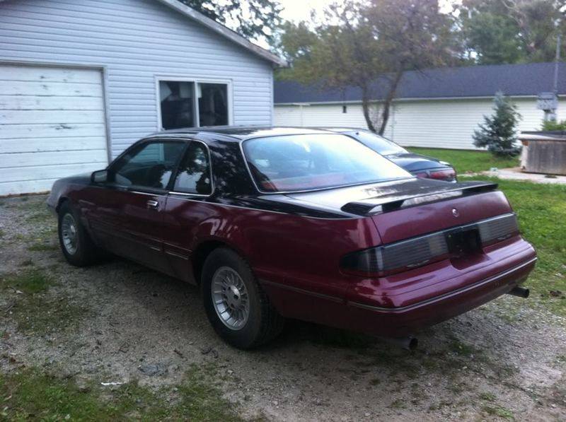

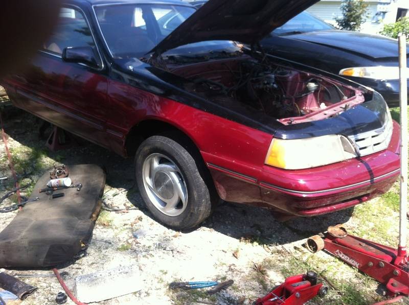

So here's a few pics as it started

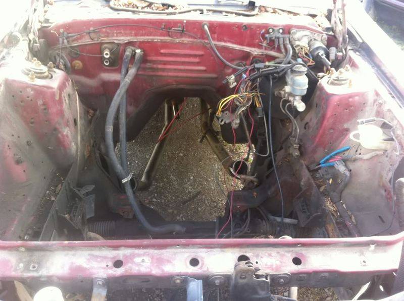

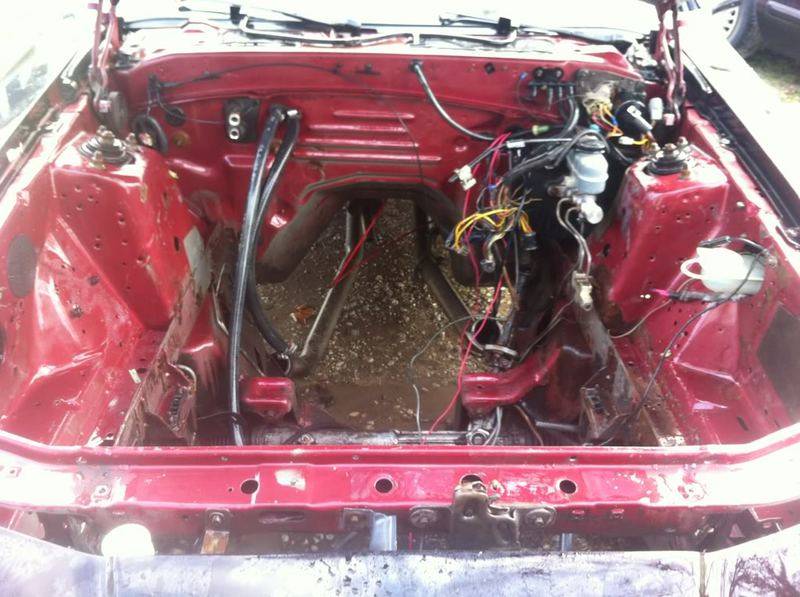

Before and after of engine compartment

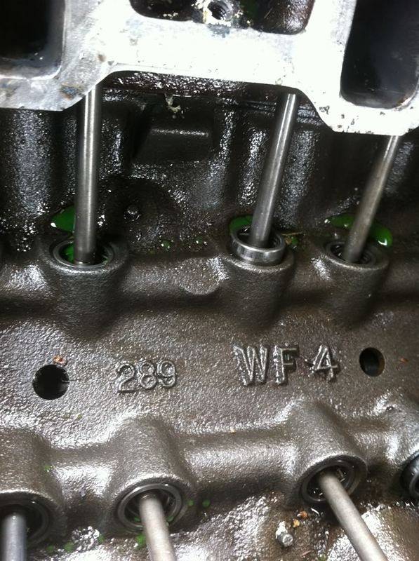

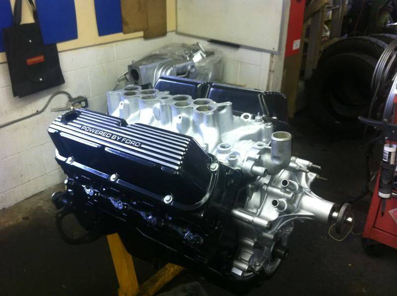

Engine

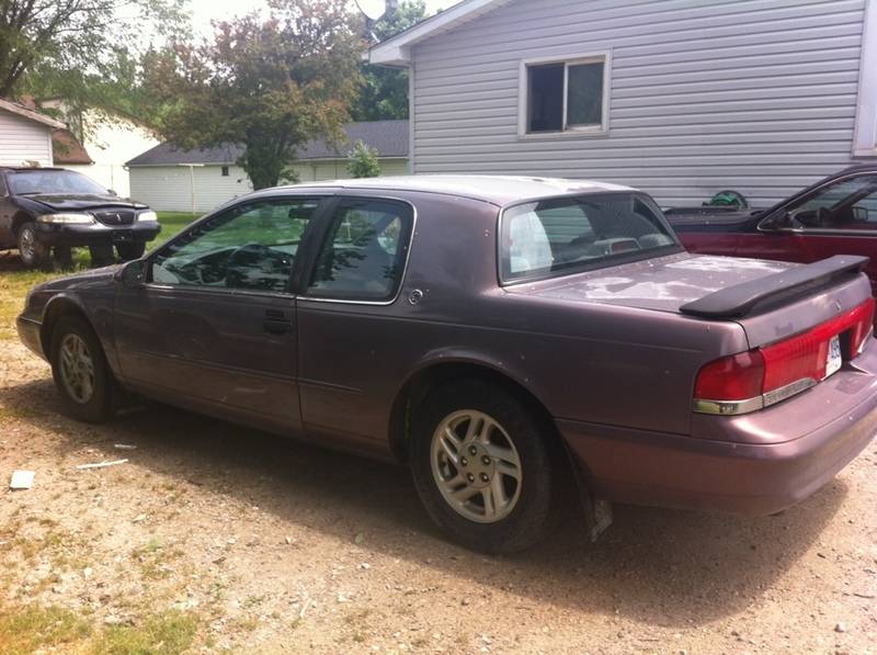

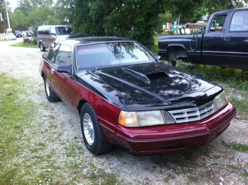

And here was another little side project this summer the gf's 1995 cougar

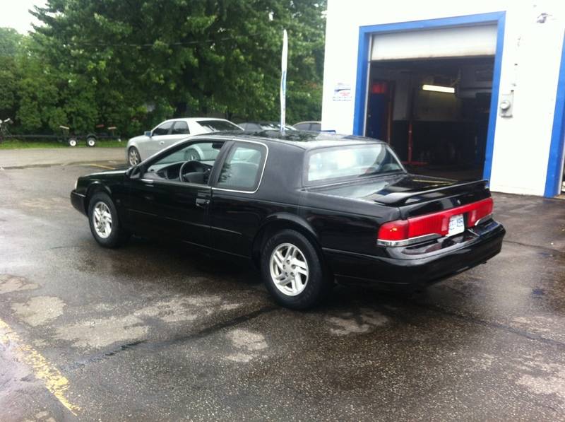

Looks like the GF is set now so, finish parting the Gen 2 setting out there and then get yours finished like you want it. Not sure what's left on the Mark so, it's hard to say what you're doing. :D
I'm parting the mark, car is rotted but has a factory rebuilt engine with only 60,000kms since installed have paper work..alot of good parts for my car
289??? In an '87 T-Bird? Stock? Or was it a swap from a previous owner? If it were me, I'd use the 289 block with the GT40 heads and EFI. Now with the 289's 2.87" stroke that would be one rev happy small block! But I'm sure that was a typo and you really meant to say 5.0 instead. Because everybody knows the '87 T-Bird had the 150hp version of the EFI 302.
Ya it was a 289...e7 heads and some lumpy cam...and I know what the car was suppose to have...this 289 would have needed a rebuild...my 306 is already to go...sold 289 to budget for my read axle ended up picking up a mostly complete 99-04 cobra IRS less axles, hubs, shocks and sway bar for $350..then found axles and 3 sets bilstiens and sway bar...sold 1 set of bilstiens, installed a set in my '98 and kept last set for the fox
Well I'll be damned. That's about a '66 block casting. I would have kept that engine and built the hell out of it. I love the 289! It's a far superior engine to the 302. It's interesting that a previous owner swapped in a 289 in place of the factory 302...

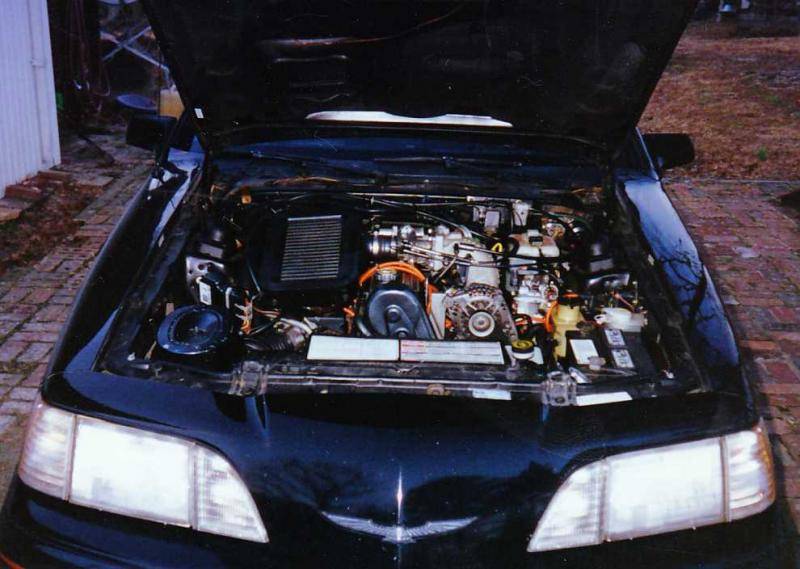

i originally almost bought a wrecked turbo coupe....but deal fell through at last minute i would have had everything but rear bumper and trunk lid as it was pushed in pretty far...little bummed out when that happen but the 2.3L turbo world can get expensive when you start to get the bug
