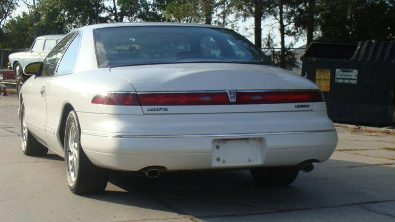

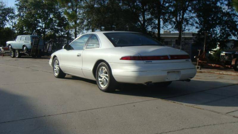

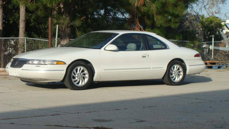

This is what mine looked like 2 months before I bought it and the tires were 245/50 I believe. It might give you an idea of how wide you're thinking about going. I personally didn't like the way they drove but anyway, it was sensor lowered as low as the brackets would allow the car to be dropped and still is with the 225's and the sig pic is with the Ray's switch having it dropped all the way. Also, if you have older bags, especially on the front, they are subject to leak air at the folds if the car is sensor lowered but might not show any signs until it gets cold out.
