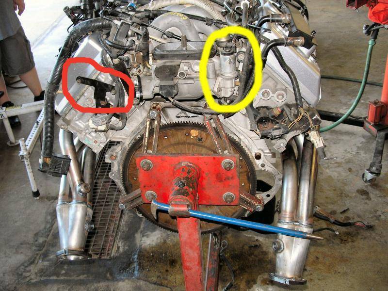

iac as seen through the dash circled in yellow
and its called the DPFE. theres 2 hoses that run off the egr tube and you can see the dpfe bracket on the back of the driverside head circled in red
dpfe usually throws a egr insufficient flow / not flowing / etc code
THAT PIC should be a Sticky, that explains SOOOO much, looking at it from that angle... Its def the EGR tube, as it feels metal....
