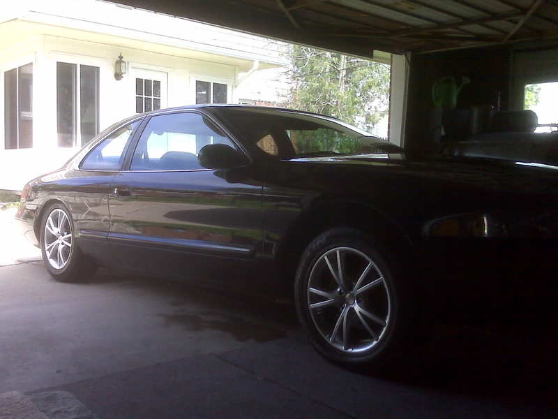

here's a rather large and not very good pic of my car
thanks they are mille miglia uno's with michelin pilot sport a/s 245/50-17's
