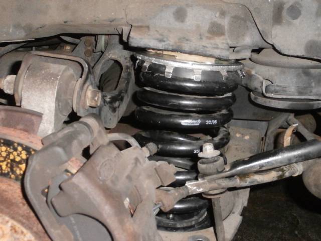

What's wrong with that stabilizer arm end link??
it's just hanging out, not tied to the LCA....waiting on a new Addco 493 (1 1/8'' rear sway bar) with end links #008...shortened sleeves to accomodate 1.5'' lowered springs
